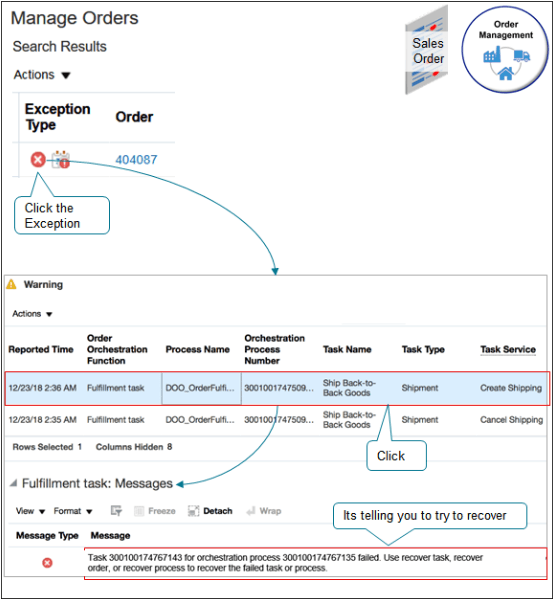

The Exception Type column displays a red circle with an x inside it to indicate whether the sales order is in error. Click the red circle.

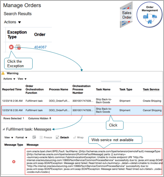

In the Warning dialog, notice that there are two errors. Click the error that happened when the orchestration process was running a fulfillment task at 2:35 AM. It's the second one in the list.
Notice the big, very technical message. It describes how the fulfillment task couldn't communicate through the web service that it uses to get shipping details from your shipment system.

Click the error that happened at 2:36. It's the first one in the list. It references a Create Shipping task. The task failed because of the first, underlying error that at happened at 2:35. The orchestration process can't create shipping if it can't communicate with your shipping system.
Notice the message. It's recommending that you try a recover action.
It's possible that the 2:35 error happened because the network was temporarily down, a sever was down or not available, and so on, which then led directly to the 2:36 error. These types of problems are often temporary and fix themselves or get fixed by someone in a few minutes. It's a good candidate for recovery because the problem might be fixed by the time recover runs.
