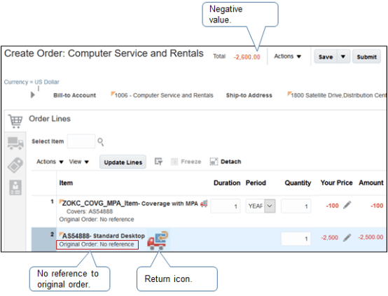

returning an item without the original sales order
Note
  • The return uses negative values to indicate it will credit the account.
  • The order line doesn't include a reference to the original order.
  • The order line uses an icon with a left facing truck to indicate a return.

  5. Submit the sales order.
    • At the top of the page, click the value next to Total, then notice that Pay Now contains a negative value.
    • Click Submit.
      If you encounter an error, then make sure you correctly set attributes on the order header and order line, such as Bill-to Account, then click Submit again.

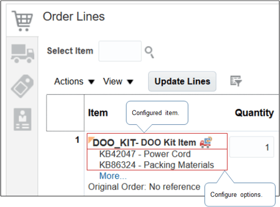

Return Kit
If you return a kit, then Order Management adds the kit and the included items on the same order line.
adding the kit and the included items on the same order line
A kit contains included items. For example, DOO_KIT-DOO Kit Item is a kit, and it contains these items.
  • KB42047 Power Cord
    KB86324 Packing Materials
You can't add a kit to an order line and then, on the same line, select included items to return. Instead, you can create a separate unreferenced return line for each included item.

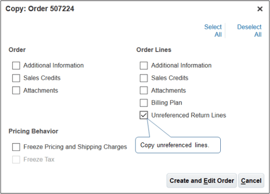

Copy Sales Orders
You can copy a sales order that includes return items that don't reference the original sales order. The copy will add unreferenced return lines to the copy. It won't add lines that do reference an original sales order.
  1. On the Order page, click Actions > Copy.
  2. In the Copy dialog, add a check mark to Unreferenced Return Lines.
    copying a sales order
The setup that your administrator makes might affect what Order Management copies. For details, see Allow Users to Return Items Without the Original Sales Order.
