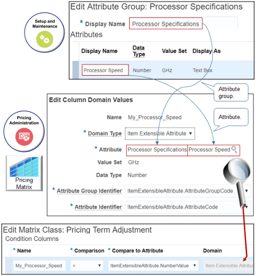

Create the Item Extensible Attribute
  1. Sign into Oracle Pricing with administrative privileges.
  2. Go to Home > My Enterprise > Setup and Maintenance > Tasks > Search > Manage Item Attribute Groups and Attributes.
  3. Create the attribute group:
    • On the Manage Attribute Groups page, click Actions > Create.
      For details, see Item Attribute Groups and Attributes.
    • On the Create Attribute Group page, create an attribute group:
      Attribute
      Value
      Display Name
      Processor Specifications
      Internal Name
      API Name
      ProcessorSpecifications
      Behavior
      Single Row
      Enabled
      Contains a check mark
      Flexfield Code
      EGO_ITEM_EFF
    • On the Context Usages tab, click Actions > Create, then set the value. Other values are optional:
      Attribute
      Value
      Name
      Item
    • Click Save
  4. Create the attribute:
    • In the Attributes area, click Actions > Create.
    • On the Create Attribute page, set the values:
      Attribute
      Value
      Name
      Processor Speed
      Internal Name
      Processor Speed
      API Name
      ProcessorSpeed
      Flexfield Code
      EGO_ITEM_EFF
      Data Type
      Number
    • Click Create Value Set.
    • On the Create Value Set page, set the values:
      Attribute
      Value
      Value Set Code
      GHz
      Description
      Gigahertz
      Module
      Product Model
      Validation Type
      Independent
      You must select Independent or Format Only for each item extensible attribute that you plan to use with Pricing.
      Value Data Type
      Number
    • Click Save and Close.
    • In the Display Properties area, set the value, then click Save and Close:
      Attribute
      Value
      Display Type
      Text Box
      You must select Text Box or List of Values for each item extensible attribute that you plan to use with Pricing.
  5. On the Edit Attribute Groups page, click Save and Close.

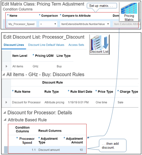

Edit the Matrix Class
Edit the matrix class so you can reference it from a rule in a discount list. For details, see Pricing Matrix Class.
  1. Go to the Pricing Administration work area, then click Tasks > Manage Matrix Classes.
  2. On the Manage Matrix Classes page, click Pricing Term Adjustment.
  3. On the Edit Matrix Class page, in the Condition Columns area, click Actions > Add Row, then set the values:
    Attribute
    Value
    Name
    My_Processor_Speed
    Source Code Name
    Accept the default value.
    Comparison
    = (equals sign)
    Compare to Attribute
    Select an attribute. For this example, processor speed is a Number data type, so select itemExtensibleAttribute.NumberValue.
    Make sure you select the same data type that you specify when you set up the attribute on the Manage Item Attribute Groups and Attributes page. If these data types don't match, then Pricing can't calculate the price.
    You can select only one of these values:
    • itemExtensibleAttribute.AttributeGroupCode
    • itemExtensibleAttribute.AttributeCode
    • itemExtensibleAttribute.VarCharValue
    • itemExtensibleAttribute.NumberValue
    • itemExtensibleAttribute.DateValue
    • itemExtensibleAttribute.TimeStampValue
  4. Set the domain:
    • In the Domain column, click Edit Domain.
    • In the Edit Column Domain Values dialog, set the value:
      Attribute
      Value
      Domain Type
    • In the Attribute field, click the magnifying glass.
    • In the Search and Select dialog, set the value, then click Search:
      Attribute
      Value
      Attribute Name
      Processor
      Pricing uses the attribute you specify in the input SDO (service data object) of the service mapping. For details, see How Service Mappings, Pricing Algorithms, and Matrixes Work Together.
      Note
      • The Search and Select dialog gets the attributes that it displays from the Manage Item Attribute Groups and Attributes page. You can search on any text as long as it matches the attributes that you define on this page.
        For example, if the Processor Specifications attribute group in the Manage Item Attribute Groups and Attributes page contains the Processor Speed attribute, then you can search Attribute Group for Processor Specifications.
      • Only some of the attributes from the Manage Item Attribute Groups and Attributes page are useful for Pricing. For example, it might contain several thousand attributes for processors for use in different contexts. You can use the attribute group to help filter the search results so they're specific to Pricing.
    • In the search results, select the attribute that your pricing matrix must reference, such as Processor Speed, then click OK.
    • Here's the dot notation that the Attribute field uses to indicate your choice:
      • Attribute_group_name.attribute_name
      For example:
      • Processor Specifications.Processor Speed
    • Set the values:
      Attribute
      Value
      Attribute Group Identifier
      ItemExtensibleAttribute.AttributeGroupCode
      Attribute Identifier
      ItemExtensibleAttribute.AttributeCode
    • Set the value, then click OK:
      Attribute
      Value
      Default Value
      1.1
      As an option, if you set Default Value, then Pricing will display it on the Discount List page that you administer later in this topic.
      Pricing gets the attribute values from that item extensible attribute that you set up. In this example, Processor Speed is a Number data type, so you can enter a numeric value. You might define another attribute differently. For example, you might define Color as a Varchar value, and with a set of values, such as blue, green, and red. So, you would select from a list instead of entering a number.

Create the Discount List
Set up a discount list so it provides a $10 discount for all 1.1 Ghz processors, to apply only on the sales charge.
  1. Create a new discount list:
    Attribute
    Value
    Name
    Processor_Discount
    Currency
    USD
    Business Unit
    Vision Operations
  2. In the search results, click Actions > Add Row, then set the values:
    Attribute
    Value
    Item Level
    All Items
    Pricing UOM
    GHz
    Line Type
    Buy
  3. Expand Discount Rules, then click Actions > Create > Attribute Based Rule.
  4. In the Create Attribute Based Rule dialog, add a check mark to Processor Speed, then click OK in the Create Discount Rule dialog, set the values, then click OK.
  5. Attribute
    Value
    Price Type
    One Time
    Charge Type
    Sale
    Charge Subtype
    Price
    Name
    Discount for Processor
  6. In the Attribute Based rule area, notice that the dialog displays the Condition Column you set up earlier in this topic, then set the values:
    Attribute
    Value
    Processor Speed
    1.1
    Notice that the attribute defaults to a value of 1.1, which is the value you set up earlier in this topic.
    Adjustment Type
    Discount Amount
    Adjustment Amount
    10
  7. Click OK.
