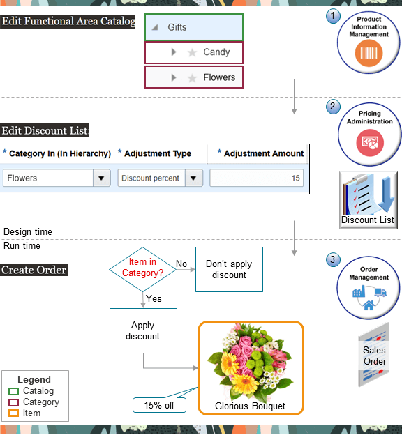

  1. Assume you use the Product Management work area to create a Gifts catalog, and it contains a child Candy category and a child Flowers category. Each child contains items. For example, Flowers contains the Glorious Bouquet item.
  2. You use the Pricing Administration work area to create a rule that applies a discount for each item that's in the Flowers category.
  3. At run time, you create a sales order in the Order Management work area, and Pricing applies your rule depending on whether the item is in the Flowers category. The Glorious Bouquet is in the Flowers category, so Pricing applies the 15% discount.
Including and excluding provides you with more flexibility when you apply price adjustments. Assume you have 10 items that are in the Flowers category, including the Glorious Bouquet and the California Poppy. You want to apply a 15% on all 10 items except you don't want to apply that discount on the California Poppy. You can create a rule that applies a discount on all items that are in the Flowers category. You can create another rule that excludes the California Poppy.

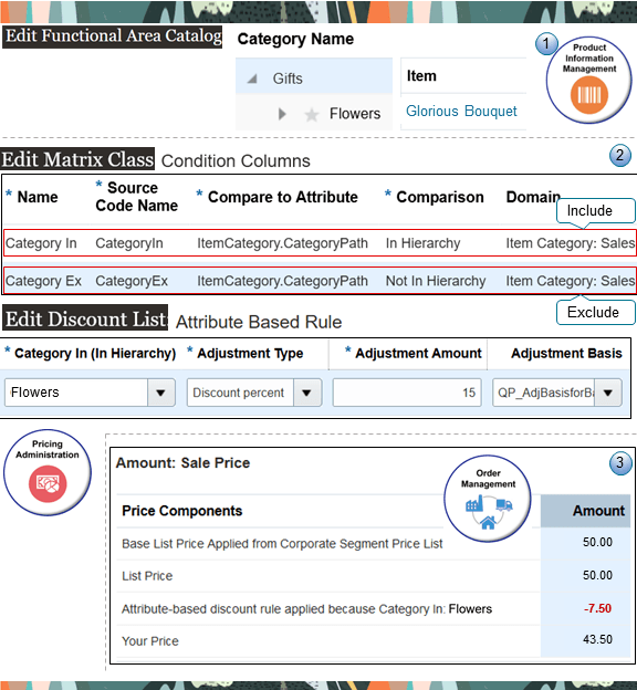

Assume you need to set up this rule:
If the item is the Glorious Bouquet, and if the item is in the Flowers category of the Gifts catalog, then apply a 15% discount.
Here's a summary of your setup:
Adjust price on a price list or a discount list according to one or more categories in a catalog.
Note
  1. Set up the category's hierarchy and assign the item to the category.
  2. Manage the matrix class and discount list.
  3. Test your work.

Manage Catalog
  1. Sign in with the privileges that you need to manage products.
  2. Go to the Product Management work area, then click Tasks > Manage Catalogs.
  3. On the Manage Catalogs page, click Create.
  4. In the dialog, set the values:
    Attribute Value
    Functional Area
    Order Entry
    You can select any area.
    Catalog Name Gifts
    Catalog Code Gifts
    Description My gift catalog
    Controlled At
    Master Level
    You can select any level.
    Category Name Flowers
    Category Code Flowers
    Description My default category
  5. Click Save and Continue.
  6. On the Edit Functional Area Catalog page, under Category Name, expand Gifts, then click Flowers.
  7. In the Details area, click Select and Add.
  8. In the dialog, search for the Glorious Bouquet item, then click Apply > OK.
  9. Run the Refresh Product Hub Snapshots scheduled process.
  10. Sign out, then sign in with the privileges that you need to administer Oracle Order Management.
  11. Go to Home > My Enterprise > Setup and Maintenance > Tasks > Search > Manage Pricing Parameters.
  12. On the Manage Pricing Parameters page, click the row that has Product Catalogs in the Name column.
  13. In the Product Catalogs area, click Add Row, add the Gifts catalog, then click Save and Close.
Manage the Matrix Class
  1. Sign out, then sign in with the privileges that you need to administer pricing.
  2. Go to the Pricing Administration work area, then click Tasks > Manage Matrix Classes.
  3. On the Manage Matrix Classes page, click Pricing Term Adjustment.
  4. On the Edit Matrix Class page, create the condition that you'll use to include the item in the adjustment:
    • in the Condition Columns area, click Actions > Add Row, then set the values:
      Attribute Value
      Name Category In
      Source Code Name CategoryIn
      Comparison In Hierarchy
      Compare to Attribute ItemCategory.CategoryPath
    • Click Save.
    • In the Domain column, click the pencil, set the values, then click OK:
      Attribute Value
      Domain Type Item Category
      Catalog Gifts
    • Click Save.
  5. While we're here, let's go ahead and add a condition that you can use to exclude the item. We'll talk about excluding later:
    • In the Condition Columns area, click Actions > Add Row, then set the values:
      Attribute Value
      Name Category Ex
      Source Code Name CategoryEx
      Comparison Not In Hierarchy
      Attribute Value
      Catalog Gifts
    • Click Save and Close.
Create Your Rule
  1. Click Manage Discount Lists, then search for and open the list that you want to use.
  2. Add the Glorious Bouquet item to your discount list, then click Save.
  3. On the Edit Discount Lists page, in the Discount Rules area, click Actions > Create > Attribute Based Rule.
  4. In the dialog that displays, under Select Optional Condition Columns, add a check mark to Category In (In Hierarchy), then click OK.
  5. In the Create Discount Rule dialog, in the Attribute Based Rule area, click Actions > Add Row, set the values, then click OK:
    Attribute Value
    Category In Flowers
    Adjustment Type Discount Percent
    Adjustment Amount 15
    Adjustment Basis QP_AdjBasisforBaseListPrc
  6. Click Access Sets, then set the value:
    Attribute Value
    Set Code
    Vision Operations
    For this example, assume you're selling in the Vision Operations business unit.
  7. Click Approve > Save and Close.
  8. Add your discount list to the pricing strategy that you use to price this item.
Test Your Work
  1. Go to the Order Management work area.
  2. Create a sales order:
    Attribute Value
    Business Unit Vision Operations
    Order Type Standard Orders
  3. Search for the Glorious Bouquet item on the order line, then click the price.
  4. Examine the price breakdown in the Amount dialog. Verify that the breakdown says:
    Attribute-based discount rule applied because Category In: Flowers In Hierarchy Flowers
