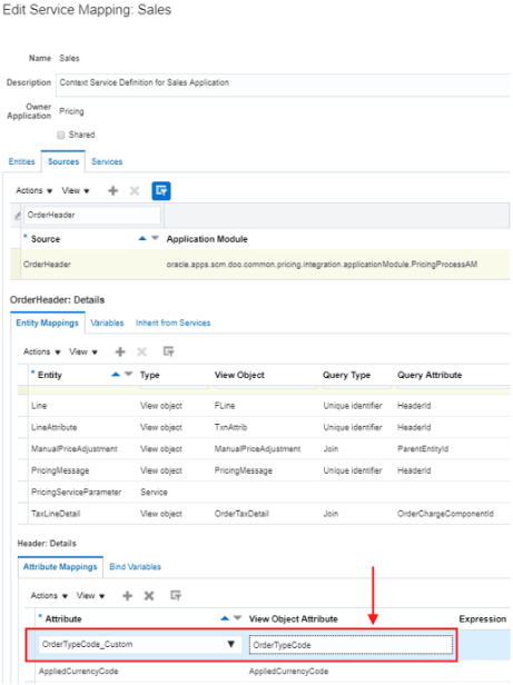

  7. Add your new attribute to the order header source:
    • Click Sources > Query by Example, then query for the OrderHeader source.
    • In the Details area, on the Entity Mapping tab, click the row that includes Header in the Entity column.
    • On the Attribute Mappings tab, click Actions > Add Row, then set the values:
      Attribute
      Value
      Attribute
      OrderTypeCode_Custom
      View Object Attribute
      OrderTypeCode
      The OrderTypeCode is a predefined view object that Order Management uses to communicate the value of the order type. This view object gets values from the ORA_ DOO_ ORDER_TYPES lookup.
      The Order Entry Specialist uses the Order Type attribute on the order header in the Order Management work area to set the value for this lookup.
      For example:
      assigning on edit service mapping page
