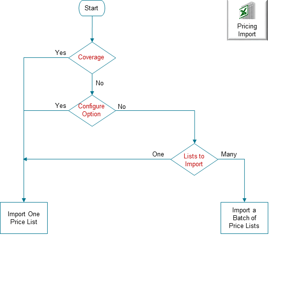

Here's a decision tree that you can use to help determine whether you can import price lists in a batch.
Note
If any of your price lists include a coverage item or a configurable option of a configured item, then don't batch. Instead, import your price lists one at a time, or import the price lists that don't have a coverage item or a configurable option separately in a batch.
If you have many price lists to import, and none of them reference a coverage item or configurable option, then import them in a batch.

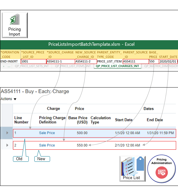

End a Charge and Create a New One
Use the End Insert operation to end date a charge that already exists, then create a new one.
Assume you need to change the base price of the sale price for the AS54111 item.
Try It
Set the values for these attributes on the QP_PRICE_LIST_CHARGES_INT worksheet.
Attribute
Description
SOURCE_PRICE_LIST_ID
Identify the price list that contains the current charge.
SOURCE_CHARGE_ID
Identify the current charge that you're ending. Use the
item-lineformat.where
itemis the name of the item, such as A54111. -
-(dash) separates the name of the item from the line. -
lineis the line number of the charge that you're ending, such as 1.
For example,
AS54111-1specifies to end the charge that's on line 1 of the charges for the AS54111 item.NEW_SOURCE_CHARGE_ID
Identify the new charge that you're creating.
Use the same format that you use for SOURCE_CHARGE_ID, except increment the line by one.
For example,
AS54111-2specifies to create line 2 in the charges for the AS54111 item.PARENT_ENTITY_TYPE_CODE
Set it to the type of entity where the charge resides.
The charge in this example is for an item on a price list, so set it to PRICE_LIST_ITEM.
PARENT_SOURCE_ID
Identify the item that contains the charges that you're modifying.
For example, AS54111 identifies the AS54111 item.
BASE_PRICE
Specify the base price to use for the new charge you're creating, such as 550.
START_DATE
Set the date to start the new charge.
End Insert uses the value in START_DATE to set the end date for the old charge.
If START_DATE happens before the end date of the old charge, then End Insert sets the end date of the old charge to START_DATE minus one second. End Insert does this to avoid a date overlap.
END_DATE
As an option, set the date to end the new charge.
If you don't include a value in END_DATE, then the import will set the end date of the charge that you identify in SOURCE_CHARGE_ID to START_DATE minus 1 second.
For example:
OPERATION_CODE SOURCE_PRICE_LIST_ID SOURCE_CHARGE_ID NEW_SOURCE_CHARGE_ID PARENT_ENTITY_TYPE_CODE PARENT_SOURCE_ID BASE_PRICE START_DATE END-INSERT 1001 AS54111-1 AS54111-2 PRICE_LIST_ITEM AS54111 550 2020/02/01 00:00:00 -
Finish the import.
End Insert will use the values that you import to end date the old charge and create a new one.
Go to the Pricing Administration work area, open the price list that contains the AS54111 item, then open the charge for the AS54111.
Verify that your import end dated the old charge, added the new charge, and set values for the new charge to the values that you specified.
Line Number Pricing Charge Definition Base Price (USD) Calculation Type Start Date End Date 1 Sale Price 500.00 - 1/1/20 12:00 AM 1/31/20 11:59 PM 2 Sale Price 550.00 - 2/1/20 12:00 AM -
If you use the:
- Create operation. The value in SOURCE_CHARGE_ID in your worksheet will replace the value in the External System Ref ID attribute in the Oracle database.
- Update operation or the End Insert operation. The import uses SOURCE_CHARGE_ID to locate the charge to update or end date.
If you don't include a value in the END_DATE attribute, then the import will set the end date of the charge that you identify in SOURCE_CHARGE_ID to START_DATE minus 1 second.
