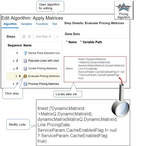

    For this example, search for, then open Apply Matrices for editing:
    Pricing runs the predefined step at run time to process the pricing matrix.
  3. On the Edit Algorithm page, click the step that contains Evaluate Pricing Matrices in the Name column.
  4. In the Step Details area, click the step that contains Matrix in the Name Column, then examine the code in the Variable Path column.
    finest {'DynamicMatrixId: '+MatrixQ.DynamicMatrixId}; dynamicMatrix(MatrixQ.DynamicMatrixId, Line.PricingDate, ServiceParam.CacheEnabledFlag != null ? ServiceParam.CacheEnabledFlag : true)

  5. In the Step Details area, scroll down, locate the First Row Actions section, then examine the code:
    • The algorithm runs this code for the first record that the query returns.
    • Pricing runs this code for each pricing matrix type except for the pricing guideline. It runs the Each Row Action for the pricing guideline.
    • Keep these points in mind during setup, maintenance, and troubleshooting.
Here's the complete code for the first row action. You must modify it in some situations. For details, see Manage Pricing Algorithms.
