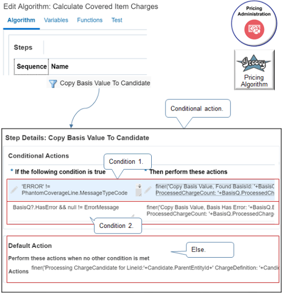

Conditional Action Step
If the primary data set meets the condition you specify, then a conditional action step does an action on all rows in the set. Here's the structure a conditional action step uses.
If (condition 1) { . . . }
else if (condition 2) { . . . }
else if (condition 3) { . . . }
else { default }
Here's some example conditions from the Copy Basis Value to Candidate step of the predefined Calculate Covered Item Charges algorithm:
example conditions from the Copy Basis Value to Candidate step of the predefined Calculate Covered Item Charges algorithm.

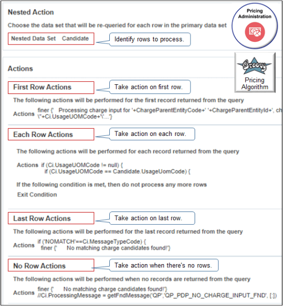

Nested Action Step
A nested action step does a different action on each row of the data set:
A nested action step does a different action on each row of the data set.
Note
  • Use the Nested Data Set to identify the rows that the nested action processes.
  • Here's what the actions do:
    An Action on This Row
    Applies the Action on This Record
    First row action.
    The first record that the query returns.
    For each row action.
    Each record that the query returns, including the first record.
    Last row action.
    The last record that the query returns.
    No row action.
    No record. Applies when the query doesn't return any records.
Here's the structure a nested action step uses.
For each Nested Set Row  {
	If First Row {. . .}
	For Each Row {. . .}
	If Last Row {. . .}
	If No Row {. . .}

  7. In the Nested Action area, notice that you can choose the data set that this step will query each time it processes a row in the primary data set.
    In this example, notice that the step comes predefined to use the Charge data set because it includes the data that the step requires to find a charge on the shipping charge list for each item, such as the PricingStrategyId to use for the order line, the SellingBusinessUnitId for the order header, and so on.
  8. In the Actions area, click Add Action, then notice that you can specify a different action for each row that the query returns.
    For example, choose First Row Actions to add an action that this step performs only on the first row that the query returns.
  9. In the First Row Actions area, in the Actions window, examine the code, and notice that it finds a charge on the shipping charge list for each item that the first row references.
    To simplify viewing, copy the code to the clipboard, then paste it into a word processing application.
  10. In the No Row Actions area, in the Actions window, examine the code, and notice that it handles a situation where the step can't locate a shipping charge list for the item.

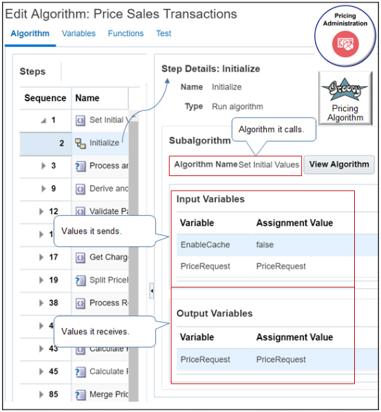

Subalgorithm Step
A subalgorithm step calls another pricing algorithm. Here's an example:
The Initialize step of the predefined Price Sales Transactions algorithm calls the Set Initial Values algorithm.
Note
  • The Initialize step of the predefined Price Sales Transactions algorithm calls the Set Initial Values algorithm.
  • Use the Algorithm Name in the Subalgorithm area to choose the subalgorithm.
  • Use input variables to specify values that the calling algorithm sends to the subalgorithm.
  • Use output variables to specify values that the subalgorithm sends to the calling algorithm.
  • The Step Details area adds variables that the subalgorithm contains when you set the Algorithm Name. If you require more, create them, then add them.
