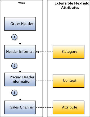

Define the Extensible Flexfield
Here's the hierarchy you define for your extensible flexfield:
hierarchy for your extensible flexfield
Note
Reference
Description
1. The Order Header references the Header Information flexfield category.
Not applicable
2. The Header Information flexfield category references the Pricing Header Information flexfield context.
A category is an organizing structure that you use to dynamically display different sets of pages and contexts at run time.
In this example, you create a single category for a flexfield so Order Management displays the same extensible flexfield context for each sales channel.
3. The Pricing Header Information flexfield context references the Sales Channel attribute.
An extensible flexfield context is a group of attributes that you use to arrange segments into meaningful groups.
For example, the Order Management work area displays each context in the same area on a page at run time.
Create the context for the extensible flexfield.

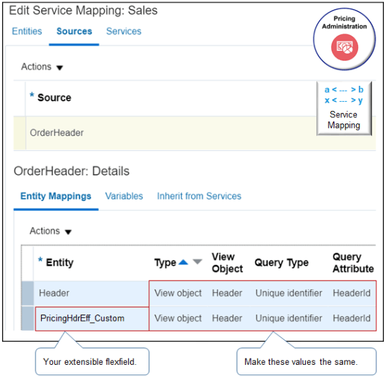

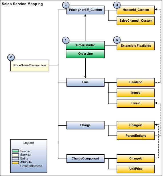

Administer the Service Mapping
Administer the service mapping that implements this SDO:
SDO for the service mapping
Here are the objects that this SDO contains:
Object
Your Work in This Example
1. Source. Provides a structure so Pricing can model data in the input SDO.
You specify the OrderHeader source on the predefined Sales service mapping. You map this source to the PricingHdrEff_Custom entity, then map the SalesChannel_Custom and HeaderId_Custom attributes to this entity.
2. Service. Requests the service mapping and receives the output SDO.
The PriceSalesTransaction service references the entities and attributes that the pricing algorithm uses to calculate the product price of each sales order.
3. Entity. References the entities that the service mapping requires to structure the output SDO.
You add the PricingHdrEff_Custom entity to the Sales service mapping.
4. Attribute. References the attributes that the service mapping requires to structure the output SDO.
You add the HeaderId_Custom attribute and SalesChannel_Custom attribute.
5. Extensible flexfields. Contains the data that this example uses.
You map the extensible flexfields that you created earlier in this topic. You map them as attributes of the PricingHdrEff_Custom entity on the OrderHeader source.
Learn about SDOs. For details, see How Service Mappings, Pricing Algorithms, and Matrixes Work Together.
Add the header entity to the service mapping.
  1. Make sure you have the privileges that you need to administer pricing.
  2. Go to the Pricing Administration work area, then click Tasks > Manage Service Mappings under Pricing Configuration.
  3. On the Manage Service Mappings page, in the Name column, click Sales.
  4. On the Entities tab, click Action > Add Row, set the values, then click Save:
    Attribute
    Value
    Entity
    Description
    Entity for the flexfield on the order header. This modification supports the business flow that uses a sales channel.
  5. In the Details area, add the attributes, then click Save:
    Attribute
    Type
    Allow Null
    HeaderId_Custom
    Long
    Contains a check mark.
    SalesChannel_Custom
    String
Specify the service.
  1. Click Services, then click the row that contains this value:
    Attribute
    Value
    Service
  2. In the Details area, on the Entities tab, click Actions > Add Row, set the values, then click Save:
    Attribute
    Value
    Entity
    Read
    Write
    Does not contain a check mark.
  3. In the PricingHdrEff_Custom Entities area, add these attributes:
    Attribute
    Read
    Write
    HeaderId_Custom
    Doesn't contain a check mark.
    SalesChannel_Custom
Specify the sources.
  1. Click Sources, then click the row that contains this value:
    Attribute
    Value
    Source
    OrderHeader
  2. In the OrderHeader Details area, click Actions > Add Row, set the \values, then click Save:
    Attribute
    Value
    Entity
    Type
    View Object
    View Object
    PricingHeaderInformation
    Make sure the value you enter for View Object matches the value from the Code attribute on the Create Context page you used when you created the extensible flexfield earlier in this topic.
    Query Type
    Unique Identifier
    Query Attribute
    HeaderId
    Make sure the value you enter for Query Attribute matches the name you used earlier in this topic when you defined the entity for the extensible flexfield.
  3. In the PricingHdrEff_Custom Details area, add the attributes:
    Attribute
    View Object Value
    HeaderId_Custom
    HeaderId
    Make sure the value you enter matches the name you used earlier in this topic when you defined the entity for the extensible flexfield.
    SalesChannel_Custom
    Saleschannel
    Make sure the value you enter matches the value of the API Name attribute on the Create Segment page that you used when you defined the extensible flexfield earlier in this topic.

Modify the Pricing Algorithm
Modify the predefined pricing algorithm so it constrains the set of records that it processes to the PricingHdrEff_Custom entity. For details, see How Service Mappings, Pricing Algorithms, and Matrixes Work Together.
  1. On the Overview page, click Tasks > Manage Algorithms under Pricing Configuration.
  2. On the Manage Algorithms page, click the row that contains the value, then click Actions > Create Version:
    Attribute
    Value
    Name
    Get Sales Pricing Strategy
  3. In the Name column, click Get Sales Pricing Strategy.
  4. On the Edit Algorithm page, on the Algorithm tab, expand step 13, Retrieve Header Strategy, then click step 14, Get Header Strategy.
  5. In the Data Sets area, click Add Row, set the values, then click Save and Close:
    Attribute
    Value
    Name
    Variable Path
    PriceRequest.PricingHdrEff_Custom
    Cardinality
    Zero or one
    Primary
    Data Set Join
    [HeaderId_Custom:{Header.HeaderId}]
  6. On the Manage Algorithms page, click Actions > Publish.
