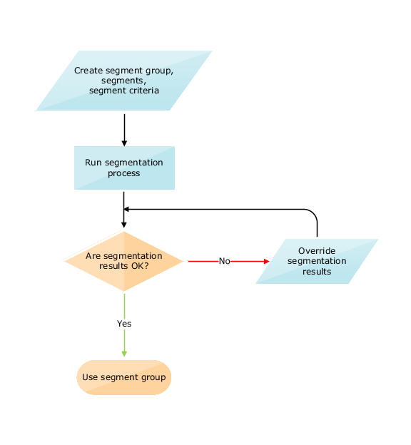

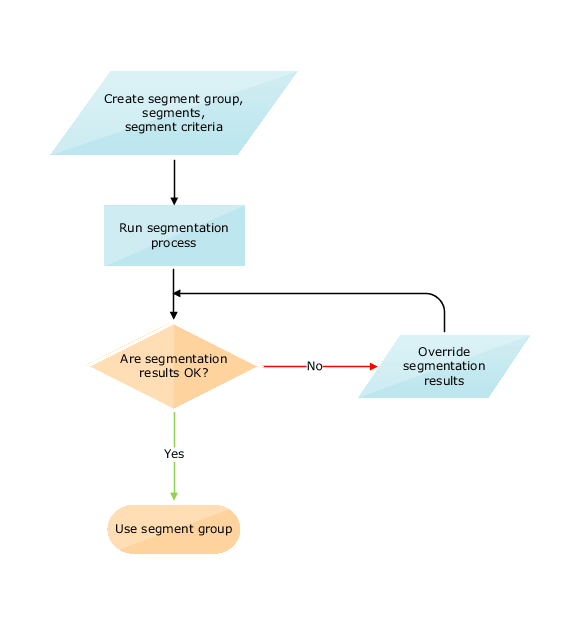

- Set up a segment group and its segments. The segment group has a specific granularity that's applicable to the segments. You specify dimension-based or measure-based criteria for each segment on the basis of which item-location combinations are assigned to the segment.
- Run the segmentation job for the segment group from the Manage Segment Groups and Criteria page ().The item-location combinations are grouped into the segments.
- View the results of segmentation, and optionally override the assignment of item-location combinations to segments to better meet your business requirements.
This flow chart summarizes the segmentation process:
         When the segments are used as members for tables and graphs, for item-location combinations that aren't associated with a segment in the segment group, the segment information is shown as "Not available."
