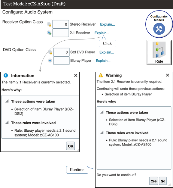

  6. Configurator will test your model. It will display visual cues for your items, such as an exclusion or automatic selection. You enabled rule explanations, so you will see an Explain link next to each item that has a runtime change, such as a user selection, system selection or exclusion, or a quantity change.
  7. Click any Explain link to get a rule explanation.

You create a rule:
Use the Bluray Player only with a 2.1 Receiver
You then test your model.
During the test, select 2.1 Receiver and select Bluray Player, click Explain next to 2.1 Receiver, then examine the details in the Information dialog.
Information
The item 2.1 Receiver is currently selected.
Here's why:
These actions were taken:
Selection of item Blueray Player (zCZ-DS12)
These rules were involved:
Rule: Bluray player needs a 2.1 sounds system; Model: zCZ-AS100
The Information dialog identifies the rule that configurator applied and why it applied that rule.
At run time, select Stereo Receiver and select Bluray Player, then examine the details in the Warning dialog that configurator displays.
Warning
The item 2.1 Receiver is currently required.
Continuing will undo these previous actions:
Here's why:
The Warning dialog tells you what item is required, what will happen if you continue, identifies the rule that configurator applied, and why it applied that rule.
