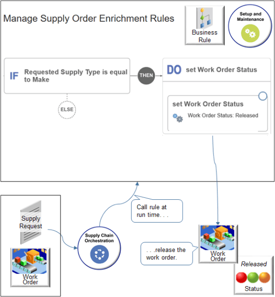

Example Rule for Work Orders
Here's an example of a rule that processes a work order:
rule that processes a work order.
It states:
  • If the Requested Supply Type attribute is equal to Make, then set the Work Order Status attribute to Released.
