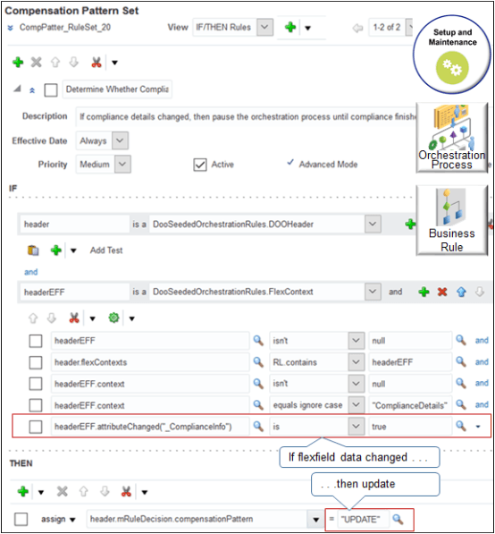

Create If Statement
You will create a statement:
If compliance details changed
Do it:
Create the rule:
Go to the Setup and Maintenance work area, then go to the Manage Orchestration Process Definitions task.
On the Manage Orchestration Process Definitions page, locate the CallCustomerWhenLargeInvoice orchestration process, then click Actions > Edit.
Learn how to create CallCustomerWhenLargeInvoice. For details, see Add Branches to Orchestration Processes.
On the Edit Orchestration Process Definitions page, in the Process Details area, in the Step Definition list, click Change Management.
In the Ship Item row, in the Compensation Pattern column, click Click for Rule.
In the Compensation Pattern dialog, click Add Rule > Properties, then set the values:
Attribute
Value
Name
Determine Whether Compliance Changed
Description
If compliance details changed, then pause the orchestration process until compliance is done.
Effective Date
Always
Priority
Medium
Active
Contains a check mark.
Advanced Mode
Tree Mode
Doesn't contain a check mark.
Declare variable
header:-
In the If area, in the window to the left of Is A, enter
header. -
Set the field to the right of Is A to DooSeededOrchestrationRules.DOOHeader.
Declare variable
headerEFF:-
Click Add Pattern.
In the window to the left of Is A, enter
headerEFF. -
Make sure
headerEFFcontains a value:-
Click Add Test.
In the window to the left of Is, enter
headerEFF. -
Change Is to Isn't.
In the field to the right of Isn't, click Right Value > null > OK.
Declare headerEFF into the rules language (RL) dictionary:
Click the down arrow located to the right of Right Value, then click Simple Test.
In the window to the left of Is, click Left Value, expand header, then click flexContexts > OK.
Change Is to RL.contains.
In the field to the right of RL.contains, click Right Value > headerEFF > OK.
Make sure
contextcontains a value:-
Click Simple Test.
Near the window to the left of Is, click Left Value, expand headerEFF, then click context > OK.
Change Is to Isn't.
Make sure
contextcontains the string ComplianceDetails:-
Click Simple Test.
Change Is to Equals Ignore Case.
In the field to the right of Equals Ignore Case, click Right Value, enter
"ComplianceDetails", then click OK.Make sure you include the double quotation ( " ) marks.
Make sure attribute ComplianceInfo of the extensible flexfield changed:
Click Simple Test.
Near the window to the left of Is, click Left Value, expand headerEFF, and then click hasChanges.
In the window in the Condition Browser, notice the value.
Insert
"_ComplianceInfo"between the parentheses, then click OK. For example:headerEFF.attributeChanged("_ComplianceInfo") -
In the window to the right of Is, enter the value.
Create Then Statement
Create the statement that pauses the orchestration process until compliance is done:
In the Then area, click Add Action > Assign.
Click Select a Target, then click header.mRuleDecision.compensationPattern.
In the window to the right of the equal sign ( = ), enter
"UPDATE".You must include the double quotation marks.
Click Validate, make sure the Validation Log that displays doesn't contain any errors, then click Save.
On the Edit Orchestration Process Definition page, click Save.

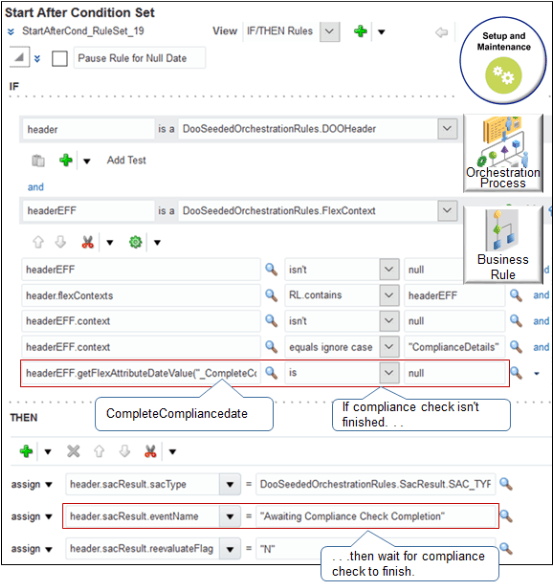

Pause the Task According to Date
You add this rule in the Pause Rule column on the same step where you added the compensation pattern.
Pause Task While Date Is Empty
Order Management sets the compliance completion date when compliance check is done. If the date is empty, then it indicates compliance check isn't done, and the rule doesn't release the pause task. For example:
If CompleteCompliancedate is empty, then compliance check isn't done. Assign a business event to indicate we must wait.
Here's the code that the rule uses.
If header is a DooSeededOrchestrationRules.DOOHeader
and if headerEFF is a DooSeededOrchestrationRules.FlexContext and
headerEFF isn't null and
header.flexContexts RL.contains headerEFF and
headerEFF.context isn't null and
headerEFF.context equals ignore case "ComplianceDetails" and
headerEFF.getFlexAttributeDateValue("_CompleteCompliancedate") is null
then
assign header.sacResult.sacType = DooSeededOrchestrationRules.SacResult.SAC_TYPE_EVENT
assign header.sacResult.eventName = "Awaiting Compliance Check Completion"
assign header.sacResult.reevaluateFlag = "N"

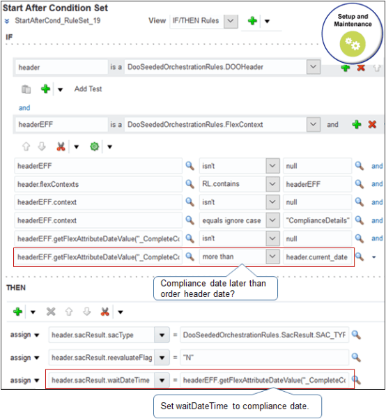

Pause for Future Date
You can create a rule that pauses until compliance completion date is later than order header date. For example:
If CompleteCompliancedate happens after order header date, then compliance check is done. Prepare to release the pause task.
To prepare to release the pause task, you set waitDateTime to the compliance date. For details about waitDateTime and sacResults, see Guidelines for Pausing Orchestration Processes:
headerEFF.getFlexAttributeDateValue("_CompleteCompliancedate") isn't null
headerEFF.getFlexAttributeDateValue("_CompleteCompliancedate") more than header.current_date
then
assign header.sacResult.sacType = DooSeededOrchestrationRules.SacResult.SAC_TYPE_TIMER
assign header.sacResult.waitDateTime = headerEFF.getFlexAttributeDateValue("_CompleteCompliancedate")

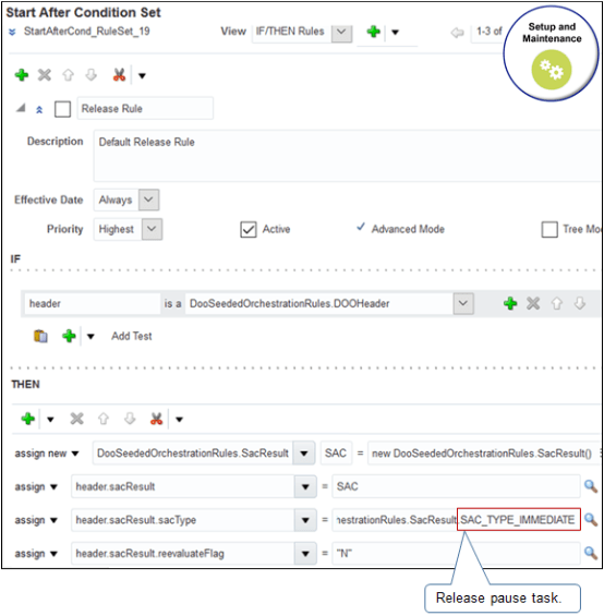

Release Pause Task
Create a rule that releases the pause task. It doesn't reference the extensible flexfield you set up earlier in this topic. Instead, it uses rules:
Pause Rule for Null Date
Pause Rule for Future Date
It uses the values that these rules set for SacResult to determine when to release the pause task.
Here's the rule that releases the pause task:
Here's the code that this rule uses.
then
assign new DooSeededOrchestrationRules.sacResult SAC = new DooSeededOrchestrationRules.sacResult()
assign header.sacResult = SAC
assign header.sacResult.sacType = DooSeededOrchestrationRules.SacResult.SAC_TYPE_IMMEDIATE
