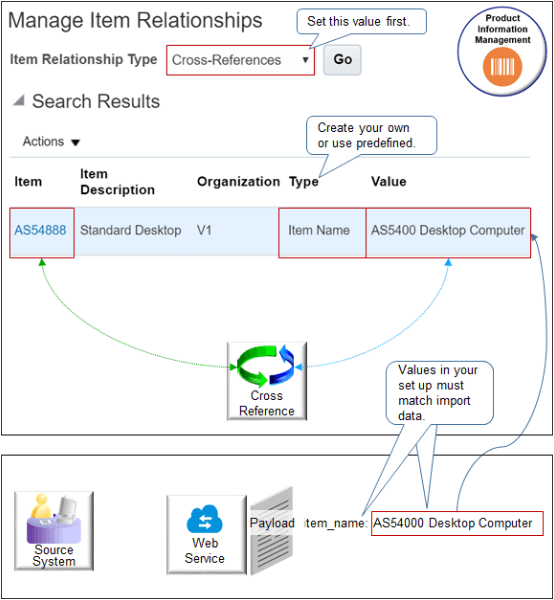

  3. Create the cross-reference:
    • Make sure you have the privileges that you need to administer Product Management.
    • Go to the Product Management work area, then click Tasks > Manage Item Relationships.
    • On the Manage Item Relationships page, set Item Relationship Type to Cross-References, then click Go.
    • In the search results, click Actions > Create
    • In the Create Cross-Reference Relationship dialog, set the values:
      Attribute
      Value
      Organization
      Vision Operations
      Item
      AS54888
      Type
      Item Name
      This is the value you created earlier in this procedure on step 2.
      Value
      AS54000 Desktop Computer
      Description
      Cross-reference to the AS54000 on our legacy source system.
    • Click Save and Close.
      Product Management creates a cross-reference between item AS54888 in Product Management and item AS54000 Desktop Computer in your legacy order capture system.
