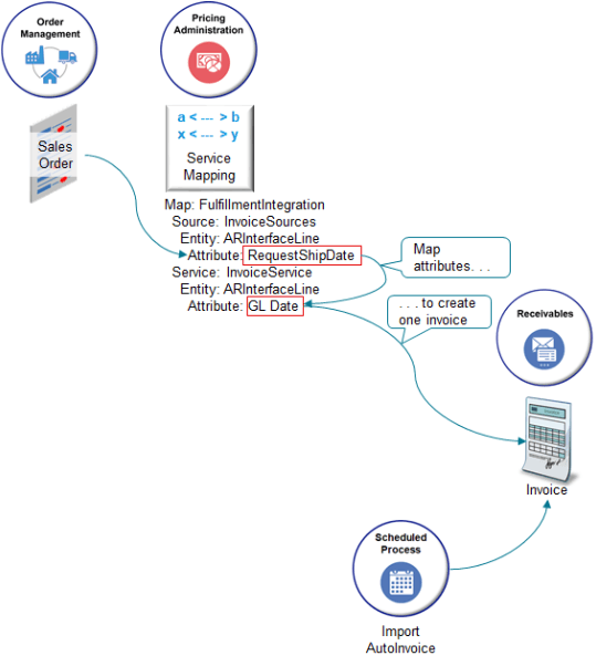

  • Use the Pricing Administration work area to create a service mapping that maps an attribute value from the sales order in Order Management, such as the requested ship date, to the GL Date attribute in Oracle Receivables. You modify the FulfillmentIntegration service mapping. It doesn't affect pricing, but it does use some of the same processing that Pricing uses. That's why its in the Pricing Administration work area.

Enable the Invoice option in the Enable Custom Payloads for Downstream Integration feature. For details, see Get Started with Integrating Order Management with Other Oracle Applications.
Set Up Service Mapping
Set up the service mapping so it can map the GL Date attribute:
  1. Open the mapping:
    • Create a sand box. For details, see Create a Sandbox So You Can Edit Service Mappings.
    • Go to the Pricing Administration work area.
    • Click Tasks, then, under Order Management Configuration, click Manage Service Mappings.
    • On the Manage Service Mappings page, in the Name column, click FulfillmentIntegration.

    • On the Edit Service Mapping page, click Sources.
    • In the Source List, click the row that has InvoiceSources in the Source column.
    • In the InvoiceSources area, on the Entity Mappings tab, click that row that has ARInterfaceLine in the Entity column.
    • In the ARInterfaceLine area, on the Attribute Mappings tab, click Actions > Add Row, set the values, then click Save:

  3. Edit the service:
    • Click the Services tab.
    • In the Service list, click the row that has InvoiceService in the Service column.
    • In the InvoiceService area, in the Entity list, click the row that has ARInterfaceLine in the Entity column.
    • In the ARInterfaceLine area, click Actions > Add Row, set the value, then click Save and Close:

  5. Go to the Scheduled Processes work area, then run the Import AutoInvoice scheduled process. For background, see Update Intercompany Receivables Invoice Import Details.
  6. Examine the results of running Import AutoInvoice. Verify that the process created a single invoice, and didn't create two invoices.
