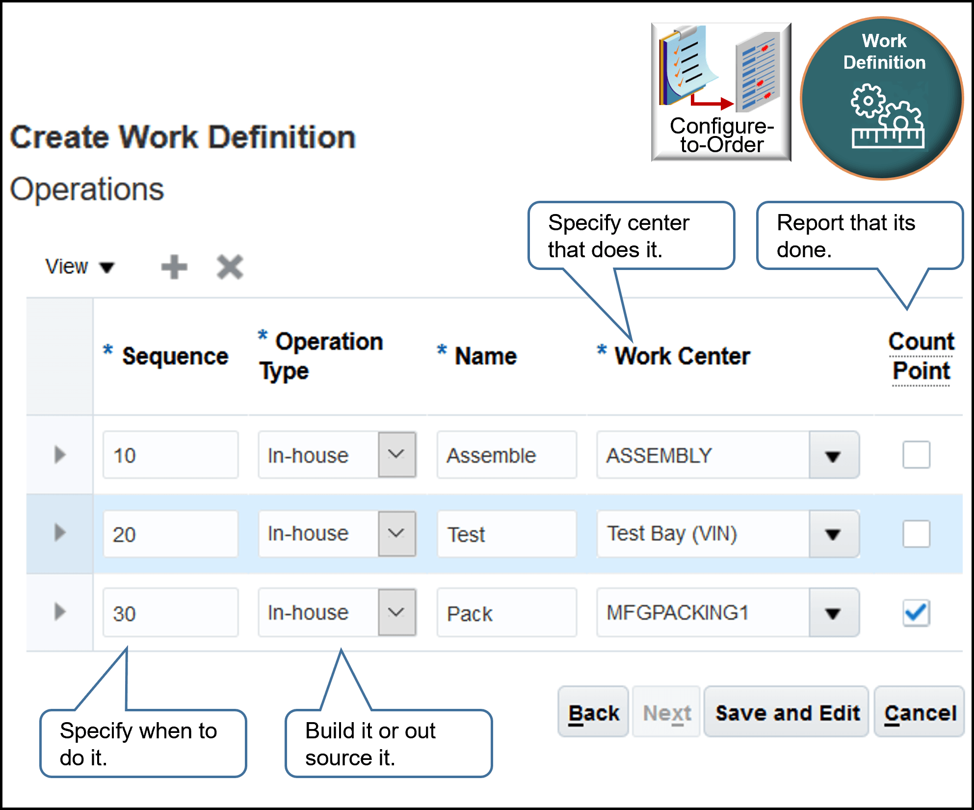

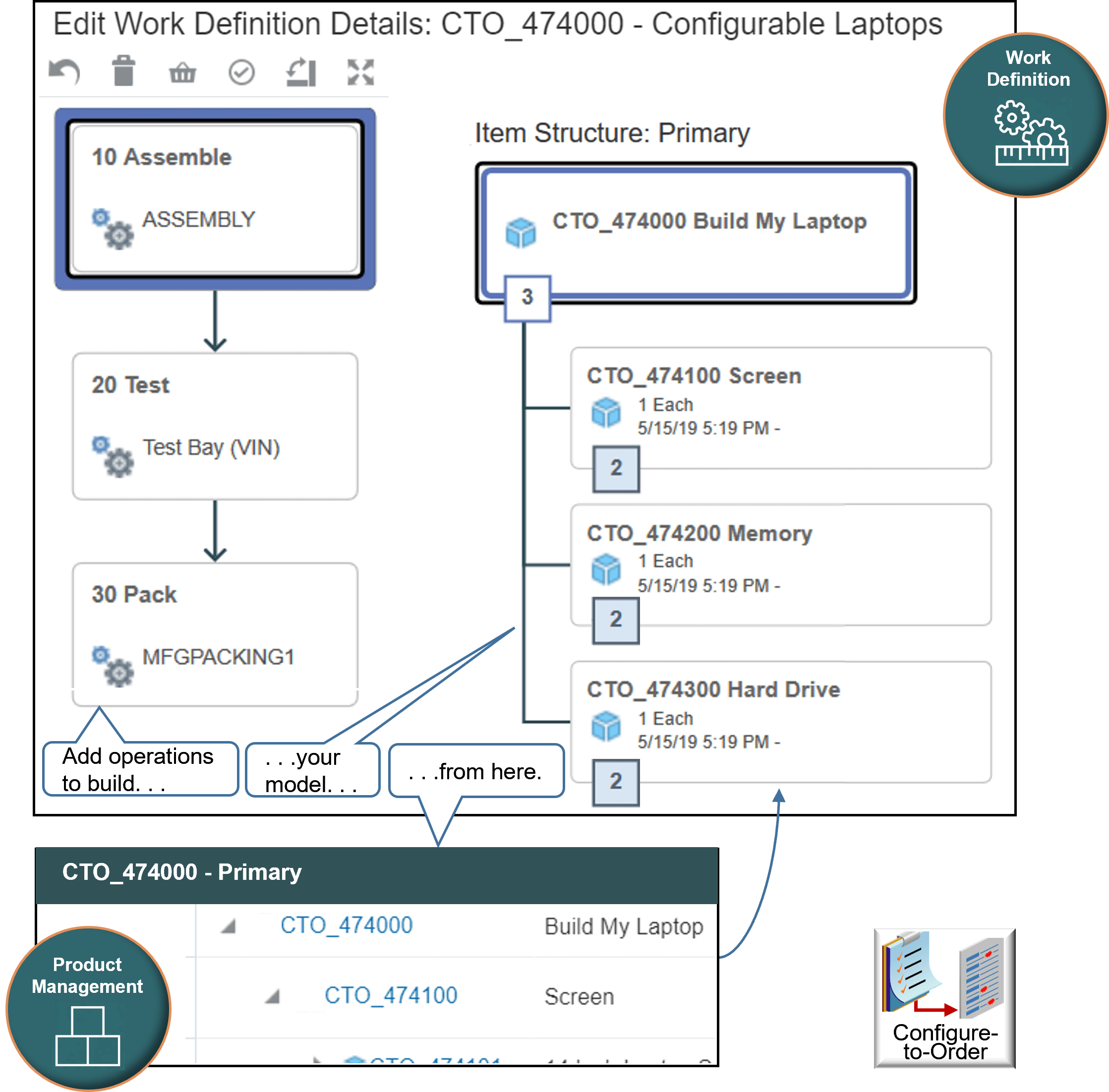

  3. Create the work definition:
    • Click Tasks > Manage Work Definitions.
    • On the Manage Work Definitions page, click Actions > Add.
    • In the Create Work Definition dialog, set the values, then click Next:
      Attribute
      Value
      Item
      CTO_474000
      Name
      Configurable Laptops
      Production Priority
      1
      Priority 1 specifies to use the primary work definition.
    • Click Add Row and set the values:
      Attribute
      Value
      Sequence
      10
      Operation Type
      In-house
      Name
      Assemble
      Work Center
      Assembly
      Attribute
      Value
      Sequence
      20
      Operation Type
      In-house
      Name
      Test
      Work Center
      Test Bay
    • Click Add Row, set the values, then click Save and Edit:
      Attribute
      Value
      Sequence
      30
      Operation Type
      In-house
      Name
      Pack
      Work Center
      MFGPACKING1
      Count Point
      Enabled
      Use this attribute to specify that the last step in the sequence is done.
      You must specify Count Point on the last step. You can also specify it on other steps to indicate activities that must finish for them.

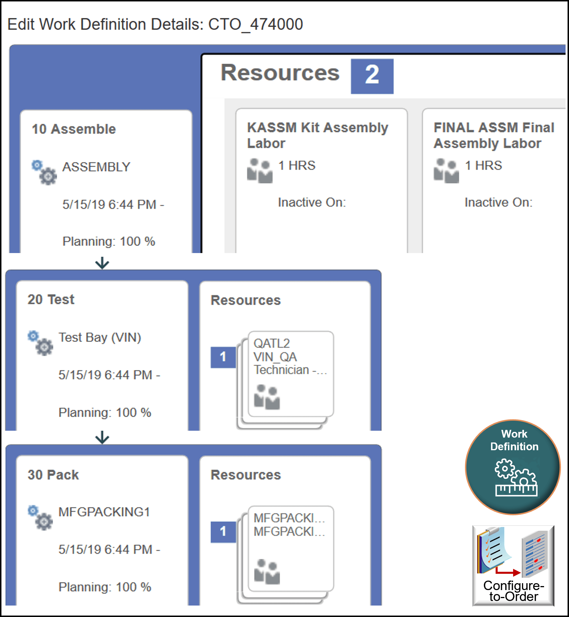

Add Resources to Operations
You aren't required to add resources to operations, but you can if you need to specifically control who does the operation. You use resources to specify how:
Try it:

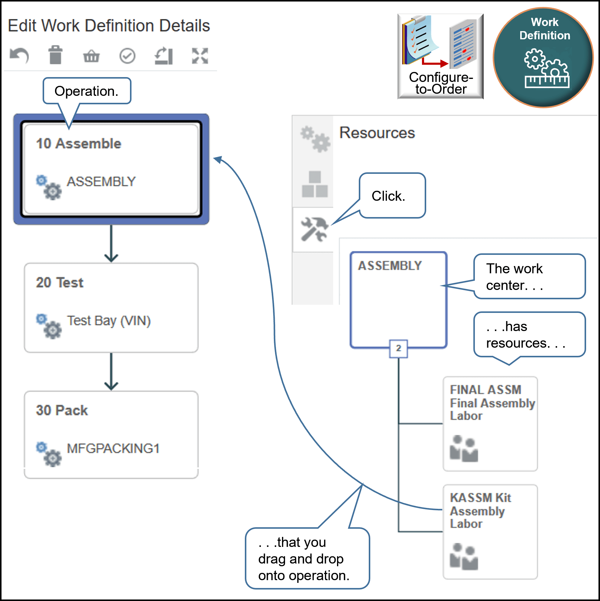

  1. On the Edit Work Definition Details page, in the area that displays the item structure, click Resources.
  2. Add resources to your first operation:
    • Click the Assemble operation.
    • Click the Kit Assembly Labor resource, drag it, then drop it onto the Assemble operation.
      Each work center has resources that do the operation. Your work center might use resources that are different than this example uses. Learn how to create a work center and it's resources. For details, see How You Manage Work Centers.
    • In the Assign Operation Resource dialog, set the values, then click OK:
      Attribute
      Value
      Units Assigned
      1
      Basis
      Variable
      This attribute determines whether you need more resources as the quantity increases when you assemble the item. You typically need more resources to assemble a laptop as quantity increases, so set it to Variable.
      Usage
      1
      Inverse Usage
      1
      Scheduled
      No
      Principal
      Not checked
      Specify priority when you use the same sequence number for more than one resource. In general, don't use the same sequence number for more than one resource. Instead, sequence them consecutively so it isn't necessary to specify a principal.
      Charge Type
      Manual
      Activity
      Setup
      For details, see How You Edit Work Definitions.
    • Click the Final Assembly Labor resource, drag it and drop it onto the Assemble operation, set the values in the dialog, then click OK.
  3. Repeat step 2 for the Test operation.
  4. Repeat step 2 for the Pack operation.
Your set up should like something like this:

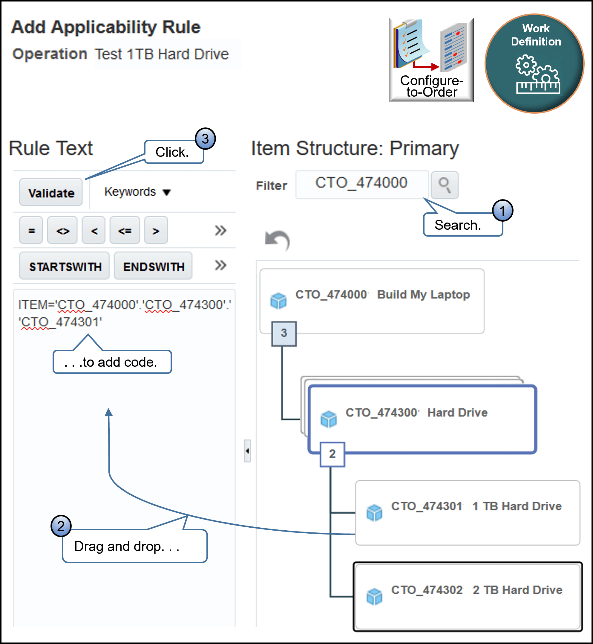

As an option, create a rule that determines when to do an operation in the work order that creates the configured item:
As an option, create a rule that determines when to do an operation in the work order that creates the configured item.
Assume you must do a performance test that depends on a configurable option your user sets in Order Management. You can create two different operations:
  • Do the 1 Terabyte Hard Drive Test operation only if the user chooses the 1 terabyte hard drive.
  • Do the 2 Terabyte Hard Drive Test operation only if the user chooses the 2 terabyte hard drive.
Try it:
  1. Go to the Work Definition work area.
  2. Create a work definition for the CTO_474000 item.
  3. Add two operations:
    Attribute
    Value
    Name
    Test 1 TB Hard Drive
    Name
    Test 2 TB Hard Drive
  4. Add a test for the 1 TB hard drive:
    • On the Edit Work Definition Details page, click the Test 1 TB Hard Drive operation, then click Actions > Edit.
    • In the Edit Operation dialog, add a check mark to Option Dependent.
    • Next to Applicability Rule, click Add.
    • In the Applicability Rule dialog, in the Item Structure area, click the CTO_474300 Hard Drive component.
    • Drag and drop the CTO_474301 1 TB Hard Drive option onto the Rule Text area.
      Notice the text area adds some code.
      ITEM='CTO_474000'.'CTO_474300'.'CTO_474301'
      CTO_474000 is the model, CTO_474300 is the option class for the hard drive, and CTO_474301 is the 1 TB hard drive.
      Here's the hierarchy the code uses.
      ITEM='model'.'option class'.'option'
    • Click Validate, then make sure the validation succeeds.
      If it fails, then troubleshoot. For details, see Troubleshoot Problems with Configure-to-Order.
    • Click OK, notice that the Edit Operation dialog displays your rule text, then click OK.
  5. Repeat step 4 for the 2 TB hard drive, except add your test to the Test 2 TB Hard Drive operation, and drag the CTO_474302 item when you create the rule.
