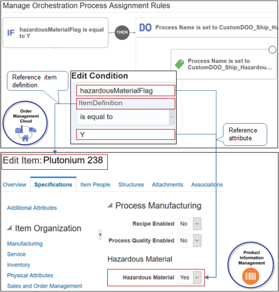

In this example, you assign an orchestration process that includes extra steps so order fulfillment safely handles hazardous material, such as packing in a controlled container and shipping through a company that specializes in shipping hazardous material. The order line doesn't come predefined with a hazardous attribute, so you reference an attribute in Product Management instead. Here's the assignment rule you will create:
  • If shipping a hazardous material, then use the Ship_Hazardous_Material orchestration process.
You create a rule that references the hazardousMaterialFlag attribute in Product Management:
rule that references attribute hazardousMaterialFlag in Product Management
Learn how to create a business rule. For details, see Overview of Using Business Rules With Order Management.

  2. Create the If statement:
    • Click New Condition.
    • In the Create Condition dialog, enter haz, wait a moment, then click harzardousMaterialFlag (Item Definition).
      The phrase Item Definition indicates that the attribute resides on an item definition in Product Management.
    • Set the operator to Is Equal To.
    • Enter Y, then click OK.
