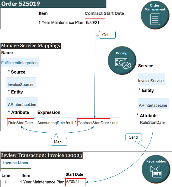

In this example you use a service mapping to map the Contract Start Date from the order line of a sales order, to the Start Date on the invoice line of an invoice in Accounts Receivable.
Note
  • You use the predefined FulfillmentIntegration service mapping. Its already set up to do most of the work for you.
  • You use predefined objects in FulfillmentIntegration to create the mapping, such as the InvoiceSources source, the ARInterfaceLine entity, and the InvoiceService service.
  • You don't have to significantly modify the predefined objects. All you need to do is add and map the attribute.
  • At runtime, the service mapping gets the value of the Contract State Date from the order line, maps it to the RuleStartDate, then sends the value to Receivables.
  • Receivables displays the value in the Start Date attribute on the invoice line.

    Specify how the payload that you send to Oracle Receivables will get the Contract Start Date from the order line on the sales order. You will write the logic to make sure you populate the RuleStartDate with the correct value:
    • Click Sources.
    • In the Sources list, click the row that has the value:
      Attribute
      Value
      Source
      InvoiceSources
    • On the Entity Mappings tab, notice that most entities use the FulfillLineVO view object to get their attribute values.
    • In the InvoiceSources Details area, on the Entity Mappings tab, click the row that has the value:
      Attribute
      Value
      Entity
      ARInterfaceLine
    • In the ARInterfaceLine Details area, on the Attribute Mappings tab, click Actions > Add Row, set the values, then click Save:
      Attribute
      Value
      Attribute
      RuleStartDate
      This value identifies the attribute that you will as the target attribute.
      Expression
      AccountingRule !null ? ContractStartDate : null
      here's what this code means. If the AccountingRule:
      • Contains a value, then use the value in ContractStartDate to populate RuleStartDate
      • Doesn't contain a value, then leave ContractStartDate empty
      You're getting the value for RuleStartDate from the FulfillLineVO view object, so you examine an attribute in the FulfillLineVO view object to see if it has a value.

    • At the bottom of the page, in the ARInterfaceLine area, click Actions > Add Row to add the RuleStartDate attribute so Order Management can communicate it through the InvoiceService:
      Attribute
      Value
      Attribute
      RuleStartDate
      Now your payload will include the RuleStartDate attribute.

    • On the Review Transaction page, in the Invoice Details area, verify the value for the invoice line that has the warranty:
      Attribute
      Value
      Start Date
      6/30/21
