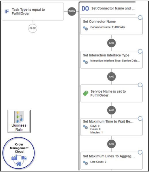

  3. In the If area, create a statement.
    If Task Type is equal to FulfillOrder
  4. In the Do area, create a statement for each attribute:
    Attribute
    Value
    Connector Name
    FulfillOrder
    Interaction Interface Type
    Service Data Object
    Service Name
    Is set to FulfillOrder
    Maximum Time to Wait Before Sending
    1 minute
    Maximum Lines to Aggregate and Send
    0
  5. Click Save and Close.

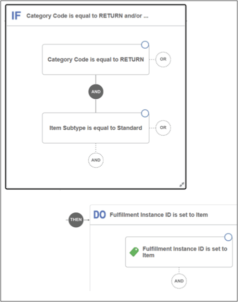

  2. In the If area, create statements.
    If Category Code is equal to RETURN
    and
    Item Subtype is equal to Standard
  3. In the Do area, create a statement for the attribute:
    Attribute
    Value
    Fulfillment Instance ID
    Is set to Item
  4. Click Save and Close.

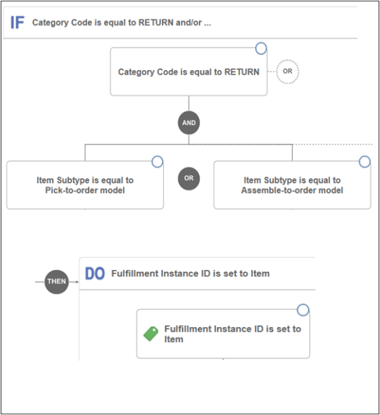

    and
    Item Subtype is equal to Pick-to-order model
    or
    Item Subtype is equal to Assemble-to-order model
    Attribute
    Value
    Is set to Item

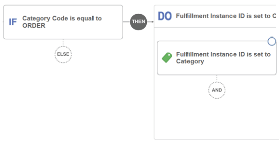

  2. In the If area, create a statement.
    If Category Code is equal to ORDER
    Tip:
    Click New Condition, then, in the Create Condition dialog, enter Category, wait for the list to display values, then click Category Code (Order Fulfill Line).
    Attribute
    Value
    Is set to Category
    Click New Action > Set a Value. In the Create Action dialog, set the top value to Fulfillment Instance ID, then, below is set to, click Attribute, then enter Category. Using this technique displays attributes that are already defined, and helps to make sure you choose an attribute that the rule can use.

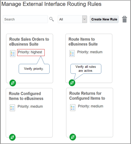

  6. Verify that you set the Route Sales Orders to eBusiness Suite rule to the highest priority, and that you activated each of your rules:
    rule that Routes Sales Orders to eBusiness Suite to the highest priority.
