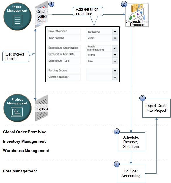

Flow to create and fulfill sales orders that include project attributes
Note
  1. Create a sales order that includes project details, such as project number, task number, and so on.
    Order Management gets the list of projects defined in Project Management, filters them according to Sales Order Business Unit and Warehouse Business Unit, then displays them as choices in the Edit Project Details dialog on the order line.
    You submit, then Order Management validates each order line that includes project details. For example, Order Management makes sure:
    • The project that you select is associated with a project contract.
    • The value in the Ship-to Address attribute on the order line matches the value in the Ship-to Address for the contract.
    • The value in the Bill-to Address attribute on the order line matches the value in the Bill-to Address for the contract.
    If validation fails, Order Management displays an error and you must update the order and submit again.
    Learn how to set up and manage projects. For details, see Using Project Costing.
  2. An orchestration process orchestrates fulfillment for the item, including schedule, reserve, and ship.
    The ProjectRecordIndicator attribute comes predefined as set to No. If you add project details, then Order Management sets it to Yes, then sends it in a request to Warehouse Management. Shipping ships the order line, then uses the indicator to determine whether to add project details to the inventory transaction.
  3. Fulfill:
    • Global Order Promising promises and schedules without the context of the project, project task, or other project details, and updates order fulfillment details.
      Global Order Promising determines the warehouse for the order line, then Order Management validates the line again immediately before the orchestration process sends the line to shipping. Order Management also sets the Scheduled Ship Date to the Expenditure Item Date so it reflects the actual transaction date.
    • Inventory Management reserves the item in inventory.
    • Warehouse Management creates the shipment, picks the item from inventory, ships the item, then sends shipment confirmation to Cost Management.
  4. Cost Management uses the sales order as input when it does cost accounting.
  5. Project Management imports costs into the project.

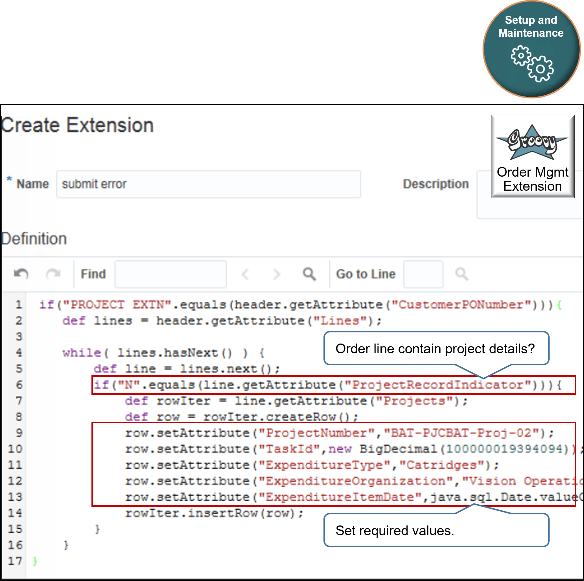

You can include project attributes in an order management extension:
Project attributes in an order management extension
Order Management calls Project Management when the On Start of Submission event happens. The call validates the changes that you make.
For example:
if("PROJECT EXTN".equals(header.getAttribute("CustomerPONumber"))){
  def lines = header.getAttribute("Lines"){
  while(lines.hasNext()){
    def line = lines.next();
        if("N".equals(line.getAttribute)("ProjectRecordIndicator"))){
          def rowIter = line.getAttribute("Projects");
          def row = rowIter.createRow();
          row.setAttribute("ProjectNumber","BAT-PJCBAT-Proj-02");
          row.setAttribute("TaskId",new BigDecimal"1000000019394094");
          row.setAttribute("ExpenditureType","Cartridges");
          row.setAttribute("ExpenditureOrganization","Vision Operations");
          row.setAttribute("ExpenditureItemDate",java.sql.Date.valueOf("2018-07-30"));
          rowIter.insertRow(row);
Note
  • Examine the ProjectRecordIndicator attribute to determine whether the order line contains project details.
  • Set a value for each of the required project attributes:
    • ProjectNumber
    • TaskId
    • ExpenditureType
    • ExpenditureOrganization
    • ExpenditureItemDate
  • Use the On Save, On Start of Submission, or On End of Submission event to read project attributes on the order line and ProjectRecordIndicator.
  • Use the On Save event or the On Start of Submission event to update project attributes on the order line.
  • Use an extension to set the project attribute's default value when the value is empty.
  • Don't use:
    • On End of Submission to update project attributes.
    • Any extension event to update ProjectRecordIndicator.
    • An extension to override an existing value of a project attribute.

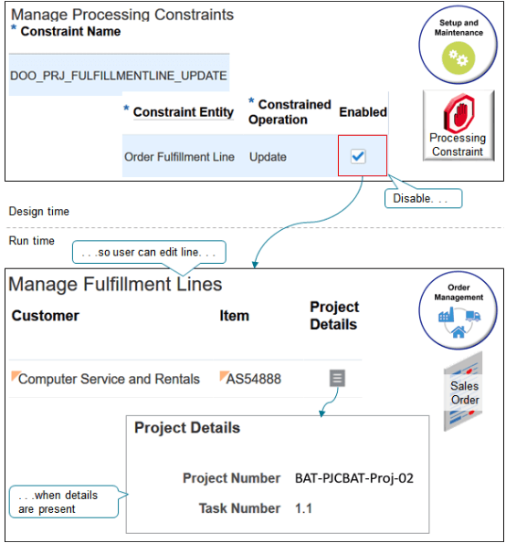

The DOO_PRJ_FULFILLMENTLINE_UPDATE processing constraint comes predefined to prevent you from updating an order line that includes project details. If you disable it, then you can update attributes that don't contain project details on the order line, such as the quantity, warehouse, and so on.
You can't update attributes that contain project details on the line after you submit the sales order even if you disable the constraint, such as project number, contract number, expenditure organization, and so on.
Order Management applies the disable behavior only on sales orders that you submit after you disable the constraint. For details, see Processing Constraints:
The DOO_PRJ_FULFILLMENTLINE_UPDATE processing constraint comes predefined to prevent the Order Entry Specialist from updating an order line that includes project details.
