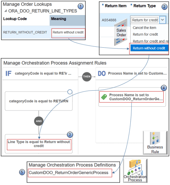

You might not want Order Management to create a credit memo, such as if you allow customers to return a competitor's order. You will set up this flow:
Note
You create a lookup that allows your user to specify whether it's a return without credit.
You search for and view a closed sales order, click Enable Returns, then set the Return Type attribute.
You create an assignment rule:
If CategoryCode is equal to Return, and
If Line Type is equal to Return Without Credit
You create an action in your rule:
Assign the CustomDOO_ReturnOrderGenericProcess orchestration process.
You create CustomDOO_ReturnOrderGenericProcess. You copy the predefined ReturnOrderGenericProcess, then remove steps so it doesn't issue a credit memo.

Summary of the Steps
Set up the lookup.
Create the orchestration process.
Create the assignment rule.
Set up the Lookup
Go to the Setup and Maintenance work area, then go to the Manage Order Lookups task.
On the Manage Order Lookups page, in the Search area, enter the value, then click Search:
Attribute
Value
Lookup Type
ORA_DOO_RETURN_LINE_TYPES
In the Lookup Codes area, click Actions > New, set the values, then click Save and Close:
Attribute
Value
Lookup Code
RETURN_WITHOUT_CREDIT
Meaning
Return without credit
Description
Return the item but don't create a credit memo.

Create the Assignment Rule
Create and publish an assignment rule that assigns your orchestration process:
Create the If statement.
If categoryCode is equal to Return, and Line Type is equal to Return without credit
Create the Then statement.
Process Name is set to CustomDOO_ReturnOrderGenericProcess -
Publish and test your rule.
