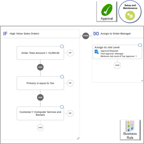

Here's the rule that you will create:
rule that you create

    Notice that the IF area now displays the condition:
    • Order Total Amount > 10,000
    • Primary is equal to Yes
    • Customer = Computer Service and Rentals

    Notice that the DO area now displays the condition:
    • Assign to Job Level

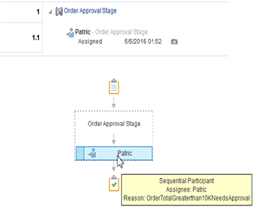

  2. Verify that Order Management updates the order status to Approval Pending.
  3. Click View Approval Information, then verify the approval details reflect the approval rule you created:
    rule that includes approval information that reflects the approval rule that you created
