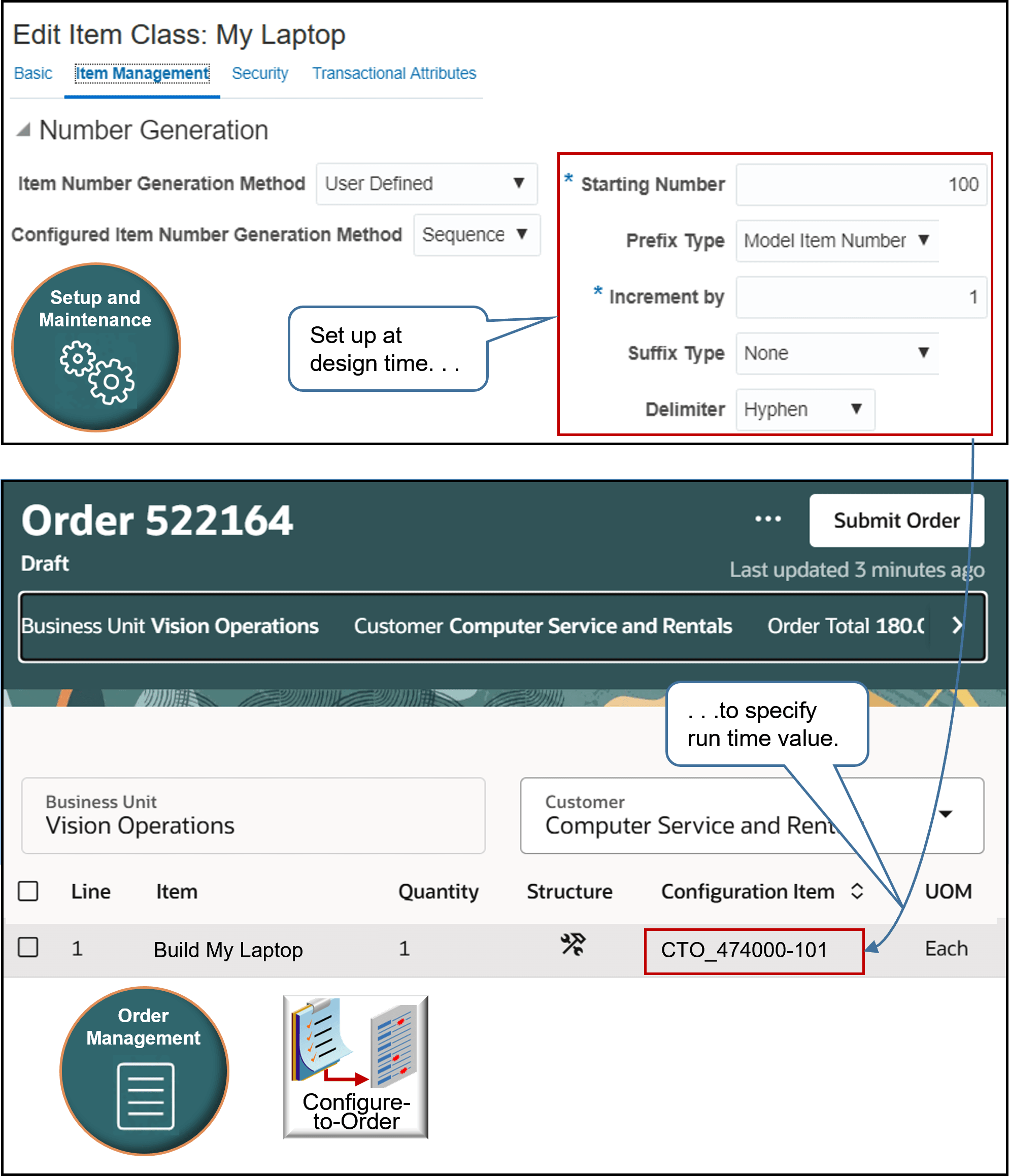

Set up the item class so that the item name for each configured item is unique. A unique name can be useful to help track and manage each item.
Here's what your setup looks like after you complete the procedure:
Set up the item class so the item name for each configured item is unique.
Note
  • You use the Edit Item Class page in the Setup and Maintenance work area to specify the number at design time.
  • Order Management displays the number in the Configuration Item attribute on the order line at run time.
Let's say you need to add a suffix to the item name for each unique configuration of item CTO_474000. You need to start the suffix with the number 100, increment it by 1 each time a user orders the item, and use a hyphen (-) to separate the suffix from the name. For example, here's the name that the flow creates the first time the user adds the item.
CTO_474000-100
where
  • CTO_474000 is the name of the configured item
  • - (the dash) is the delimiter
  • 100 is the starting number of your sequence
Here's the name for the next time a user adds the item.
CTO_474000-101
The number is unique across order lines, sales orders, and users.

Modify the Class
  1. Go to the Setup and Maintenance work area, then go to the Manage Item Classes task.
  2. On the Manage Item Classes page, in the search results list, search for, then open the My Laptop class for editing.
  3. On the Edit Item Class page, click Item Management, then set the values:
    Attribute
    Value
    Item Number Generation Method
    User Defined
    This means you, the administrator, defines numbering. Not the end-user who creates the sales order.
    Configured Item Number Generation Method
    Sequence
  4. In the Details area, set the values:
    Attribute
    Value
    Starting Number
    100
    Prefix Type
    Model Item Number
    Specify what displays before the starting number.
    Increment By
    1
    Suffix Type
    None
    Specify what displays after the starting number.
    Delimiter
    Hyphen
    Specify the character that separates the starting number from the prefix or the suffix.
  5. Click Save and Close.

  5. Notice that the value of the order line's Configuration Item attribute is CTO_474000-100.
  6. Notice that the value of the Configuration Item attribute on the next order line is CTO_474000-101.
