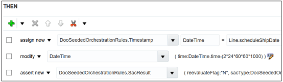

This statement adds the pause and specifies to release it two days before the scheduled ship date happens:
statement that adds the pause and specifies to release it two days before the scheduled ship date happens
Create the Then statement:
  1. Assign the result:
    Code Description
    Assign new DooSeededOrchestrationRules.SacResult SAC = new DooSeededOrchestrationRules.SacResult()
    Create a new variable named SAC and set it to the SacResult type in the DooSeededOrchestrationRules method.
    Assign Header.sacResult = SAC
    Set the value of the sacResult object on the order header to the value that SAC contains.
    For brevity, the screen print doesn't assign the result from the rules dictionary and to the header, but you must assign that result. For details, see the Assign the Result subtopic in Guidelines for Pausing Orchestration Processes.
  2. Use Assign New to create a variable named DateTime. You will use this variable to calculate the amount of time to delay shipment:
    • In the Then area, click Add Action > Assign New.
    • Click Select a Target > DooSeededOrchestrationRules.Timestamp.
    • In the empty attribute immediately to the right of Select a Target, enter DateTime.
      Don't include quotation marks. Adding DateTime in this attribute creates the variable that this example uses for the date calculation.
  3. Select the order line attribute that you will use to calculate the date:
    • Click Expression Value.
    • In the Condition Browser, expand Line.
      The dialog displays a list of order line attributes. You can set up you rule so it considers the value of one of these attributes.
    • Click scheduleShipDate > OK.
    • Make sure the attribute where you added DateTime still contains DateTime.
    • Click Add Action > Modify.
    • Click Select a Target > DateTime.
  4. Calculate the amount of time to delay shipment:

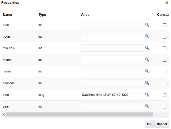

    • Click Edit Properties.
    • In the Properties dialog, in the Time row, click Value.

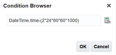

    • In the Condition Browser, expand DateTime, then click Time.
      Note that the Condition Browser adds a value of DateTime.time to attribute Expression.
    • In the Expression attribute, append -(2*24*60*60*1000) to the end of DateTime.time.
      where
      • 2 is the number of days.
      • 24 is the number of hours in one day.
      • 60 is the number of minutes in one hour.
      • 60 is the number of seconds in one hour.
      • 1000 is the number of milliseconds in one second.
      This value calculates the number of milliseconds so the pause task ends two days before the orchestration process schedules the order lines for shipping.
      You can use the getAdjustedDate instead function of DateTime.time.
    • Make sure the Expression attribute includes DateTime.time-(2*24*60*60*1000), then click OK.
      For example:
      condition browser with DateTime.time-(2*24*60*60*1000)
    • Make sure the Properties dialog includes the value in the time property:
      values in Properties dialog
    • Click OK.

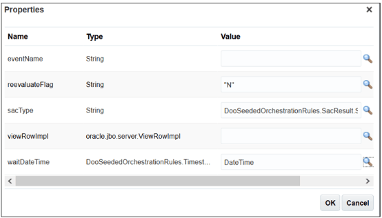

  5. Pause the orchestration process.
    You will set these properties.
    ( reevaluateFlag:"N", sacType:DooSeededOrchestrationRules.SacResult.SAC_TYPE_TIMER, waitDateTime:DateTime )
    • Click Add Action > Assert New.
    • Click Select a Target > DooSeededOrchestrationRules.SacResult.
    • In the Properties dialog, in the reevaluateFlag row, in the Value attribute, enter "N". You must include the double quotation marks.
    • In the sacType row, click Value.
    • In the Condition Browser dialog, expand DooSeededOrchestrationRules > SacResult, click SAC_TYPE_TIMER, then click .
      A pause type of TIMER causes the orchestration process to pause until time elapses.
    • In the Properties dialog, in the waitDateTime row, click Value.
    • In the Condition Browser, click DateTime, then click OK.
    • Make sure the Properties dialog contains these values:
      dialog with the required values
