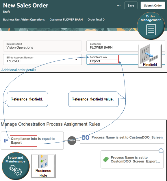

You will create an assignment rule that references the extensible flexfield:
assignment rule that references the extensible flexfield.
You will create this assignment rule:
  • If the Trade Compliance Details flexfield contains the value Export, then assign the order line to the Screen_Exports_for_Trade_Compliance orchestration process.

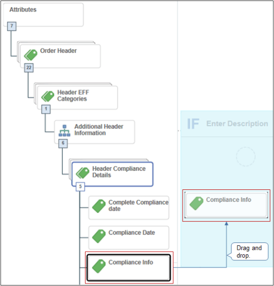

  3. Create the If statement:
    • Click in the If area to expand it.
    • On the Attributes tab, expand Order Header > Header EFF Categories > Additional Header Information > Header Compliance Details.
    • Click Compliance Info, drag it, then drop it into the IF area:
      dragging and dropping in the rule
    • In the Create Condition dialog, set the operator to Is Equal To.
    • Enter Export, then click OK.
