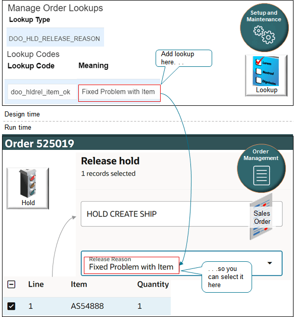

Create a Release Reason
Create a reason that your user can choose to indicate why they released the hold:
Create a reason that your user can choose to indicate why they released the hold.
Try it:
  1. Go to the Setup and Maintenance work area, then go to the Manage Order Lookups task.
  2. On the Manage Order Lookups page, enter the value, then click Search:
    Attribute
    Value
    Lookup Type
    DOO_HLD_RELEASE_REASON
  3. In the DOO_HLD_RELEASE_REASON: Lookup Codes area, click Actions > New then set the values:
    Attribute
    Value
    Lookup Code
    doo_hldrel_item_ok
    Display Sequence
    1
    Start Date
    The current date.
    End Date
    One week from today.
    Meaning
    Fixed Problem with Item
    Description
    Fixed the problem with the item.
  4. Click Save and Close.
