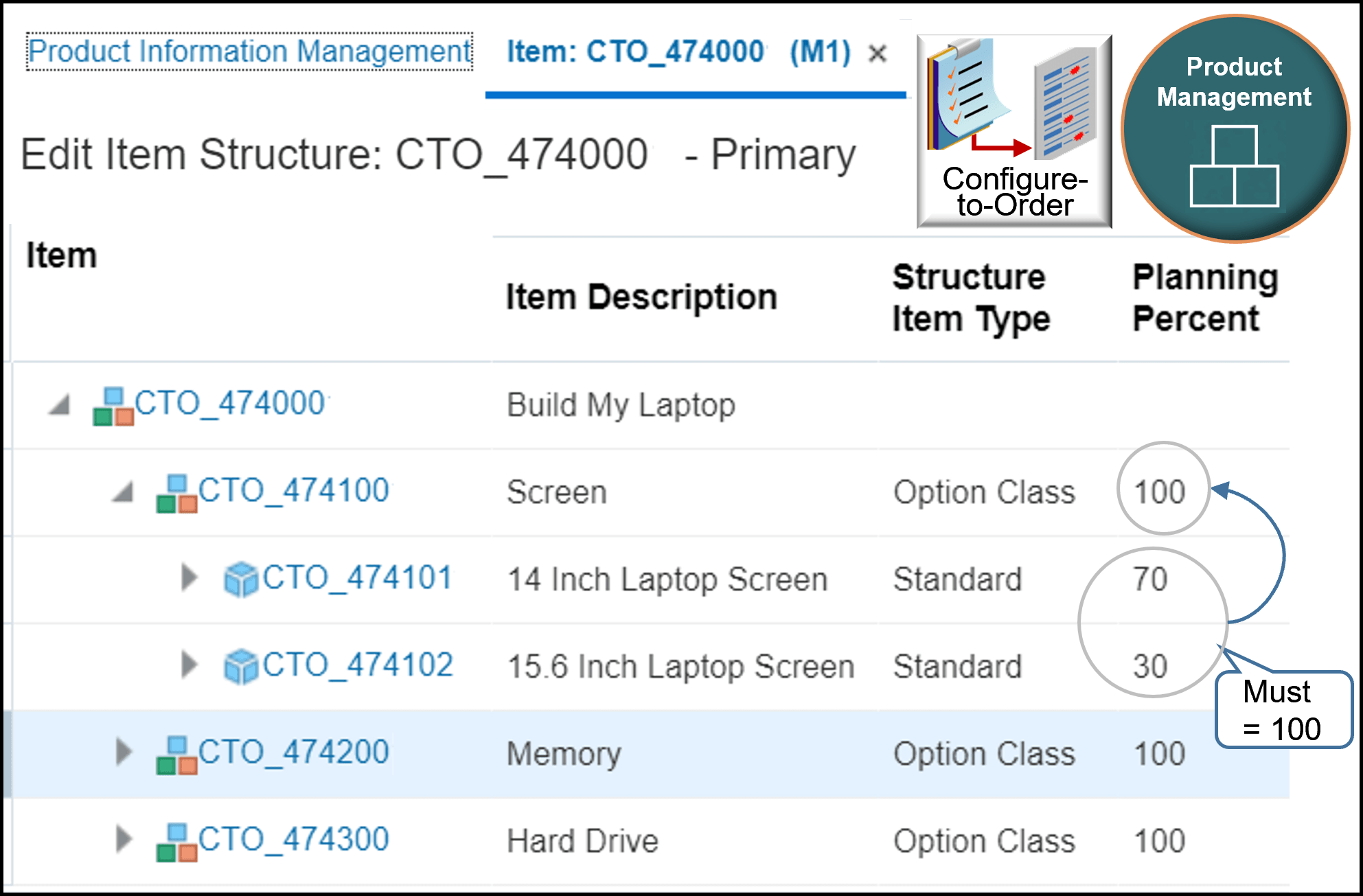

Assume your market research indicates you expect demand will be about 70% for the 14" screen option and 30% for the 15.6" screen option. Here's your set up:

  • The sum of the values you set for configurable options in a single class must equal 100%.
  • The Planning Central work area uses the value you set when it forecasts demand.

  6. On the Edit Item Structure: CTO_474000 - Primary page, expand the screen option, then verify your values:
    Object
    Planning Percent
    CTO_474100 Screen
    100
    CTO_474101 14 Inch Laptop Screen
    70
    CTO_474102 15.6 Inch Laptop Screen
    30
