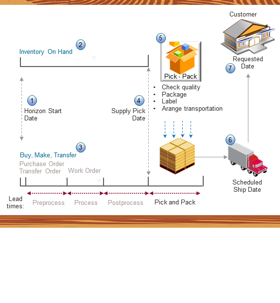

Here’s a summary of how it works.
Note
- Start the promising horizon. The promising horizon is the number of days that Promising considers when it promises your item, such as the number of days to look at in your calendar or in the lead time, the availability for the item's supply, resources, supplier capacity, and so on. For more about the horizon, see Manage Promising Profiles.
- If you’re using supply that’s already on hand in inventory, then Promising sets the Supply Pick Date to the date when it finds that supply is available in inventory and ready to pick.
- If you’re using a buy or transfer flow, then Promising applies your preprocessing lead time, processing lead time, and postprocessing lead time to determine the Supply Pick Date. If you’re using a make flow, then Promising applies your processing and postprocessing lead times. Either way, Promising uses your organization’s calendar to help determine the Supply Pick Date.
- The Supply Pick Date indicates the earliest date that supply is available to pick.
- Promising uses the value that you set in Pick and Pack Lead Time attribute to determine how much time to add so you can pick and pack the item. You can use this time for a variety of reasons according to your specific requirements, such as to do a quality assurance process, package and label the item, arrange for special transportation, and so on.
- Promising calculates the scheduled ship date as the Supply Pick Date plus the
pick and pack lead time.
Promising also considers the transit time needed to ship the item between the Scheduled Ship Date and the Scheduled Arrival Date in the usual way.
- You ship the item to your customer so it arrives by the Requested Date on the sales order.
Note that you can’t view the Supply Pick Date on the sales order. Instead, use the Check Availability page to view it.
