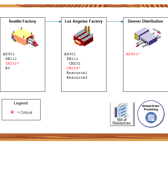

Detailed Lead Time Example
Consider this flow.
Consider this flow.
Note
  • The assembled AS301 item is critical in the Denver Distribution Center.
  • Subassembly SB111 in the Los Angeles Factory isn't critical.
  • The CM202 item in the Seattle Factory is critical, and it is two levels below the AS301.
  • The CM153 item in Los Angeles is critical, and it is one level below the AS301.
  • You have done all the required Promising setups, such as sourcing rules, assignment sets, ATP rules, and so on.
Here are your transit times between facilities:
From To Transit Time
Los Angeles Denver 2
Seattle Los Angeles 3
Here are your lead times:
Item Organization Critical Processing Lead Time Postprocessing Lead Time
AS301 Denver Yes 2 days 4 days
AS301 Los Angeles No 2 days 3 days
SB111 Los Angeles No 1 day 1 day
SB111 Seattle No 1 day 1 day
Here are the lead times that the scheduled process creates in your bill of resources:
Assembly Assembly Organization Component Component Organization Lead Time
AS301 Denver CM202 Seattle 17 days
AS301 Denver CM153 Los Angeles 11 days
Here's the calculation for the CM202's 17 day lead time:
Lead Time Calculation for the CM202 Running Total
1 day processing plus 1 day postprocessing for the SB111 in Seattle equals 2 days 2
3 days transit time to get from Seattle to Los Angeles
2 + 3 = 5
1 day postprocessing for the SB111 in Los Angeles 5 + 1 = 6
2 days processing plus 3 days postprocessing for the AS301 in Los Angeles equals 5 more days 6 + 5 = 11
2 day transit time to get from Los Angeles to Denver 11 + 2 = 13
4 days postprocessing for the AS301 in Denver 13 + 4 = 17
Here's the calculation for the CM153's 11 day lead time:
Lead Time Calculation for the CM153 Running Total
2 days processing plus 3 days postprocessing for the AS301 5
2 days transit time to get from Los Angeles to Denver 5 + 2 = 7
4 days postprocessing for the AS301 7 + 4 = 11
