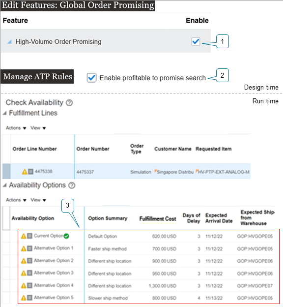

Here's what you do:
  1. Enable the High Volume Order Promising feature. Promising will include the cost that you incur to ship the item from the ship from location to your customer's site when you schedule the arrival date. You can also include a manufactured item’s resource cost and material cost from a bill of resources.
  2. Enable profitable to promise on your ATP rule. Use it so you can change the source that you would normally use to fulfill the item to a source that's more cost effective.
  3. At run time, use the Check Availability action to examine the default availability option that Promising is currently using and alternative options that might be more cost effective, for example, by using a different shipping method or by shipping from a different location. Use the default, or select an alternative.
    For example, select from one of these:
    Availability Option Option Summary Fulfillment Cost Days of Delay Expected Arrival Date Expected Ship From Warehouse
    Current Option Default Option $620 3 1/1/2023 Denver
    Alternative Option 1 Faster Ship Method $700 3 1/1/2023 Denver
    Alternative Option 2 Different Ship Location $900 3 1/1/2023 Seattle
    Alternative Option 3 Different Ship Location $950 3 1/1/2023 Portland
    Alternative Option 4 Different Ship Location $1,300 3 1/1/2023 San Francisco
    Alternative Option 5 Slower Ship Method $800 4 1/2/2023 Denver
Notice how the action prioritizes on time delivery over cost. For example, option 5 costs less than options 2, 3, and 4, but option 5 is last in the list because it adds another day of delay.

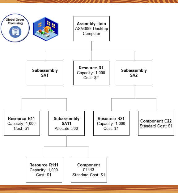

Example
Assume you have this supply chain network.
Assume
  • You need to promise an order line for the AS54888 Desktop Computer item, with a quantity of 10.
  • The AS54888 includes subassembly SA1 and subassembly SA2.
  • You use the R1 resource to assemble SA1 and SA2.
  • Capacity is for each day and cost is for each unit. For example, R1 can build 1,000 units each day at a cost of $2 for each unit.
  • You make each subassembly from other subassemblies or manufacturing components, and you use different resources to assemble them.
  • You build the subassemblies and the AS54888 in you factory.
  • All manufacturing components and resources are available in the factory.
To calculate the total fulfillment cost, Promising adds the standard cost for each of the manufacturing components. It then adds the resource costs that you incur to build the subassemblies and the AS54888.
Resource or Manufacturing Component Cost for Each Unit Quantity Total
C22 $1 10 $10
C1112 $1 10 $10
R1 $2 10 $20
R21 $1 10 $10
R11 $1 10 $10
R111 $1 10 $10
- - Total Fulfillment Cost: $70
Note
  • Promising uses the critical manufacturing components and critical resources from the bill of resources.
  • Promising looks at all possible paths through your supply chain, then gives you the least expensive path.
  • Promising doesn't return the individual cost for any assembly or subassembly when you build the item. Instead, it returns the cost when it promises the AS54888 from your available to promise inventory after you finish building the item.

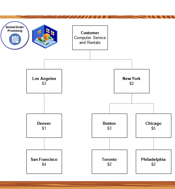

How Promising Examines Your Supply Chain Network
Example 1
Note
  • You need to promise an order line that has a quantity of 20.
  • The requested arrival date on the line is the system date.
  • A quantity of 10 units are available on the requested arrival date at every organization in your network.
  • You can split the line across factories but you must deliver the entire quantity together in a single shipment.
Promising will look at every node in your network until it has fulfilled the requested quantity:
Result Supply Chain Path Fulfillment Cost Math
Default Los Angeles first, and then Denver $40
  • 10 units in Los Angeles at $3 each equals $30.
  • 10 units in Denver at $1 each equals $10.
  • $30 plus $10 equals $40.
Alternative 1 New York first, and then Boston $50
  • 10 units in New York at $2 each equals $20.
  • 10 units in Boston at $3 each equals $30.
  • $30 plus $20 equals $50.
Note
  1. Promising will start with the default path, which is Los Angeles.
  2. If the Los Angeles path can't meet demand, then Promising will look at the New York path.
  3. The Los Angeles path costs less, so Promising will promise from Los Angeles.
Example 2
Assume the same scenario except with a quantity of 30:
Default New York first, then Boston, then Toronto $70
  • 10 units in Toronto at $2 each equals $20.
  • $20 plus $30 plus $20 equals $70.
Alternative 1 Los Angeles first, then Denver, then San Francisco $80
  • 10 units in San Francisco at $4 each equals $40.
  • $30 plus $10 plus $40 equals $80.
Alternative 2 New York first, then Chicago, then Philadelphia $90
  • 10 units in Chicago at $5 each equals $50.
  • 10 units in Philadelphia at $2 each equals $20.
  • $20 plus $50 plus $20 equals $90.
Note
  1. Promising will start with New York as the default path.
  2. If the New York path can't meet demand, then Promising will look at Boston because Boston is more cost effective than going through Philadelphia.
  3. If Boston can't meet demand, then Promising will look at the Los Angeles path because going through Los Angeles is more cost effective than going through Philadelphia.
