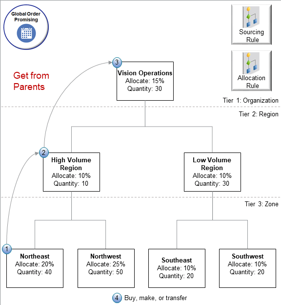

Get Supply from a Node's Parent
Set up a hierarchy that gets supply from a node's parent and distributes it to other nodes.
Assume you have this hierarchy, and you will get supply for the sales order from all three levels of the hierarchy.
Here's the sequence that Promising will use to allocate supply. It’s the same one that's in Use Lower Priority Supply to Fulfill Higher Priority Demand but with a few important differences:
Step Description Remaining Balance
1 You create a Sales Order in the Northeast node for the AS54888 computer with a quantity of 100, and Order Management populates the three attributes that you reference in your allocation hierarchy to All, High Volume, and Northeast. Promising consumes all 40 units of the supply that's available to allocate in the Northeast node, which is in the lowest level, first. 220 minus 40 equals 180.
2 Promising consumes the 10 units of supply that's available to allocate in Northeast's parent, High Volume Region. 180 minus 10 equals 170.
3 Promising still needs 170 units, so it consumes the 30 units that are available in High Volume's parent, Vision Operations. 170 minus 30 equals 140.
4 Promising still needs 140 more units to fulfill the 220 units on the order line, so it uses your ATP rules and sourcing rules to make, buy, or transfer the remaining 140 units. 140 minus 140 equals 0.

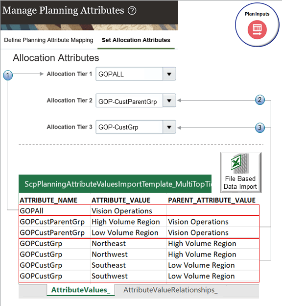

  3. Click Set Allocation Attributes. Make sure you enabled the features earlier in this procedure. If you didn't, you won't see the Set Allocation Attributes tab.
  4. Set the values:
    Attribute Value
    Allocation Tier 1 GOPAll
    Allocation Tier 2 GOPCustParentGrp
    Allocation Tier 3 GOPCustGrp
  5. Click Save and Close.
    Promising automatically creates an attribute set named BM_Attr_Hrcy. You must use this value when you import. We'll show you how next.

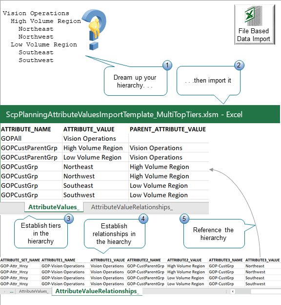

What the Numbers Mean
  1. Think about how the hierarchy that you'll need to prioritize and fulfill demand.
  2. Use file-based data import to import your thoughts into Oracle Applications.
  3. Use the AttributeValues tab to establish tiers in the hierarchy.
  4. Use the AttributeValueRelationships tab to establish relationships for each node in the hierarchy.
  5. Reference the hierarchy that you create on the AttributeValues tab.

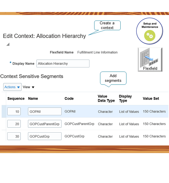

Create an Extensible Flexfield
  1. Add a context that has three segments to the predefined Fulfillment Line Information extensible flexfield.Fulfillment Line Information extensible flexfield. Add a context that has three segments
    Use these values:
    Sequence Name Code Value Data Type Display Type Value Set
    10 GOPAll GOPAll Character List of Values 150 Characters
    20 GOPCustParentGrp GOPCustParentGrp Character List of Values 150 Characters
    30 GOPCustGrp GOPCustGrp Character List of Values 150 Characters

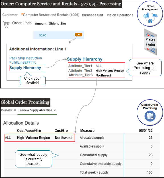

    You will view this flexfield in the Order Management work area to see how Promising allocates supply on the order line.
    The context name that you use must match the context code that you specify on the Manage Contexts page. For details about this page and how to setup and deploy flexfields, see Use Extensible Flexfields to Add Your Attributes in Order Management.

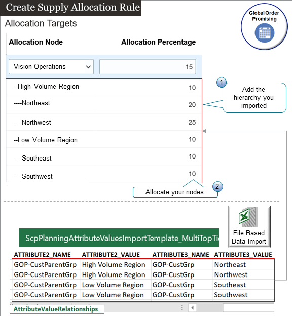

Create an Allocation Rule
You will add the nodes that you imported as a hierarchy, and then allocate each one of them.
get supply from the node parent
Try it:
  1. Go to the Order Promising work area.
  2. Click Tasks > Manage Supply Allocation Rules.
  3. On the Manage Supply Allocation Rules page, search for the value:
    Attribute Value
    Name Supply for Vision Operations
    Specification Type Percentage
  4. Click Actions > Edit.
  5. On the Allocation Targets tab, click Actions > Add Row, then set the values:
    Attribute Value
    Start Date Choose a Sunday.
    End Date Choose a Sunday.
    Each allocation rule works on a weekly basis that starts and ends on Sunday.
  6. In the Allocation Targets area, click Actions > Add Row to add each node:
    Allocation Node Allocation Percentage
    Vision Operations 15
    High Volume Region 10
    Northeast 20
    Northwest 25
    Low Volume Region 10
    Southeast 10
    Southwest 10
    Note
    • Set the Node Rank attribute to zero.
    • Set the Stealing Protection Percentage attribute to zero.
    • Don't set any values in the Date Range to Consider Shipping History area or in the Allocation Targets area.
    • Notice that the page automatically prefaces each node with a series of hyphens. This isn't part of the node's name, but it does help you to visualize the hierarchy.
  7. Click Allocation Assignment, then set the values:
    Attribute Value
    Assignment Basis Item
    Assigned to Item AS54888

  2. Create a sales order:
    • Go to the Order Management work area, then create a sales order:
      Attribute Value
      Customer Computer Service and Rentals
      Business Unit Vision Operations
    • Add an order line and set these attributes:
      Attribute Value
      Item AS5488
    • Click Submit.
    • Go to Home > Order Management > Order Management (New) > Manage Orders.
    • Query for and open your order.
    • On the order line, click the down arrow, then click View Additional Information.
    • In the dialog that displays, click GOP Attributes.
    • Notice that the dialog displays details about your allocation hierarchy that Promising has applied to the line, such as the parent entity and the node that Promising is using to promise the item at each tier, such as High Priority Region and Northwest.
    • Click Actions > Switch to Fulfillment View.
    • On the Fulfillment Lines tab, click Schedule.
  3. Examine the revised allocation:
    • Repeat step 1.
    • In the Allocation Details area, notice how Promising consumed supply according to your allocation set up. It consumed all the supply for the Northwest node first. It then consumed supply from the Northwest Region in the middle tier, and finally then the Vision Operations node in the top tier. It consumed supply from Northwest's parent and then Northwest's grandparent until it had all the supply it needed to meet demand.
      You can also use the Supply Allocation Availability REST API to get allocation data. For details and examples, go to REST API for Oracle Supply Chain Management Cloud, then search for Supply Allocation Availability.
