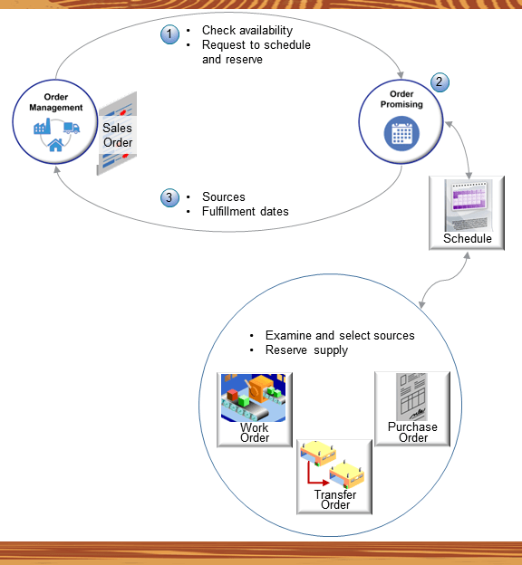

Oracle Global Order Promising is an application that helps you fulfill sales orders by the requested date for items that you receive from your ordering application, such as Oracle Order Management.
Promising considers the supply that is or might be available in your entire supply chain, including suppliers, factories, distribution centers, and warehouses.

  1. Order Management sends a request that includes these details to Promising. The request might be to check and see whether the item is available, or to schedule and reserve the item for fulfillment.
  2. Promising uses its schedule to look at a variety of sources that can fulfill demand within the date that Order Management requested, depending on how you set it up. For example, it can try to get supply from:
    • Work orders that create supply for the item in manufacturing
    • Transfer orders that transfer supply between organizations when that supply already exists
    • Purchase orders that purchase supply for the item from a supplier
  3. Promising sends supply details to Order Management, including the source that will supply the item, fulfillment dates, and so on.

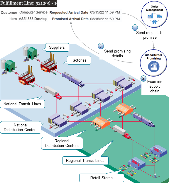

Consider this example of a supply chain.
Here's an example of a supply chain.
How it works:
  1. Order Management sends a request to Promising to promise an item, such as the AS54888 Computer, according to the requested arrival date.
  2. Promising uses the set ups that you make in the Global Order Promising work area to examine the supply chain and promise the item so it arrives at your customer's site by the requested arrival date.
  3. Promising sends promising details to Order Management, such as the Promised Arrival Date.
