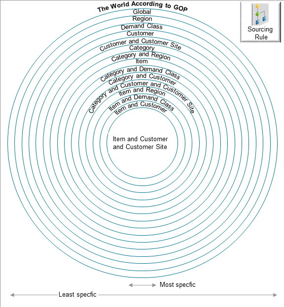

Assignment Level Hierarchy
  • Your assignment levels create a hierarchy in the assignment set.
  • Promising uses the hierarchy to determine which sourcing rule to use when it searches the supply chain for a source for your item.
  • Promising uses the most specific sourcing rule in the hierarchy first.

Assignment Levels for Global Sourcing Rules
Here are the levels for your global sourcing rules, listed from the most specific in row 1, to the least specific in row 15:
Specificity Assignment Level Assign the Sourcing Rule When Applies for All
1 Item and Customer and Customer Site The order line has the item, the customer, and the customer site that you specify on the assignment.
  • Organizations
  • Demand Classes
  • Categories
  • Regions
2 Item and Customer The order line has the item and the customer that you specify on the sourcing assignment.
  • Customer's sites
  • Organizations
  • Demand classes
  • Categories
  • Regions
3 Item and Demand Class The order line has the item, and the sourcing rule's demand class matches the demand class that you specify on the assignment.
  • Customers
  • Customer sites
  • Organizations
  • Categories
  • Regions
4 Item and Region The order line has the item and the region that you specify on the assignment.
  • Customers
  • Customer sites
  • Organizations
  • Demand Classes
  • Categories
5 Category and Customer and Customer Site The order line has the customer and customer site that you specify on the assignment, and the Product Category on the order line matches the category that you specify on the assignment.
  • Items
  • Organizations
  • Demand Classes
  • Regions
6 Category and Customer The order line has the customer that you specify on the assignment, and the Product Category on the order line matches the category that you specify on the assignment.
  • Items
  • Customer's sites
  • Organizations
  • Demand Classes
  • Regions
7 Category and Demand Class The Product Category on the order line matches the category that you specify on the assignment, and the sourcing rule's demand class matches the demand class that you specify on the assignment.
  • Items
  • Customers
  • Customer sites
  • Organizations
  • Regions
8 Item The fulfillment has the item that you specify on the assignment.
  • Customers
  • Customer sites
  • Organizations
  • Demand Classes
  • Categories
  • Regions
9 Category and Region The Product Category on the order line matches the category that you specify on the assignment, and the order line has the region that you specify on the assignment.
  • Items
  • Customer
  • Customer sites
  • Organizations
  • Demand Classes
10 Category The Product Category on the order line matches the category that you specify on the assignment.
  • Items
  • Customers
  • Customer sites
  • Organizations
  • Demand Classes
  • Regions
11 Customer and Customer Site The order line has the customer and the customer site that you specify on the assignment.
  • Items
  • Organizations
  • Demand Classes
  • Categories
  • Regions
12 Customer The order line has the customer that you specify on the assignment.
  • Items
  • Customer sites
  • Organizations
  • Demand Classes
  • Categories
  • Regions
13 Demand Class The sourcing rule's demand class matches the demand class that you specify on the assignment.
  • Items
  • Customers
  • Customer sites
  • Organizations
  • Categories
  • Regions
14 Region The order line has the region that you specify on the assignment.
  • Items
  • Customers
  • Customer sites
  • Organizations
  • Demand Classes
  • Categories
15 Global The order line, sourcing rule, or assignment doesn't have to have any specific value.
  • Items
  • Customers
  • Customer sites
  • Organizations
  • Demand Classes
  • Categories
  • Regions
Here's another way to visualize it.
