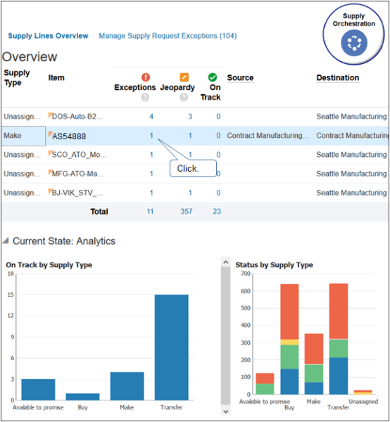

  1. Go to the Supply Orchestration work area:
    • Use the Analytics area on the Overview page to get a high level view of your supply orders, including ones that are on track and ones that aren't.
    • Search the Item column for AS54888, then click the link in the Exceptions column.

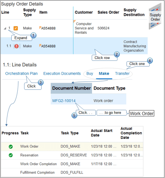

  3. Examine the Supply Order Details page:
    Examine the Supply Order Details page.
    Note
    1. Expand the top line so you can view the line that contains the exception.
    2. Click the row that contains the exception so you can view details about it.
    3. Click Orchestration Plan so you can see the current state of the tasks that the orchestration process is running.
      In this example, the orchestration process successfully created the work order task and the reservation task, started but hasn't finished the work order completion task, and hasn't started the fulfillment completion task.
    4. In the Line Details area, click the Make link. Note that links contain data depending on the type of flow. In this example you click Make because its make flow. The Buy and Transfer links don't contain any data because the flow isn't buy or transfer.
    5. Click the link in the Document Number column to go to the work order.

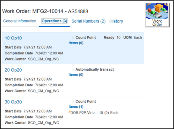

  4. Examine the Work Order page:
    Examine the Work Order page.
    Note
    • The page title includes the work order number and the item number. For example, MFG2-10014 AS54888.
      where
      • MFG2-10014 is the work order number.
      • AS54888 is the item number.
    • Details vary depending on the type of work order. For example, some work orders include serial numbers, others don't.
    • Click Operations to see what operations the work center has done to build the AS54888.
    • Click History to see remaining quantity, completed quantity, scrapped quantity, transaction history, inspection history, and other details.
