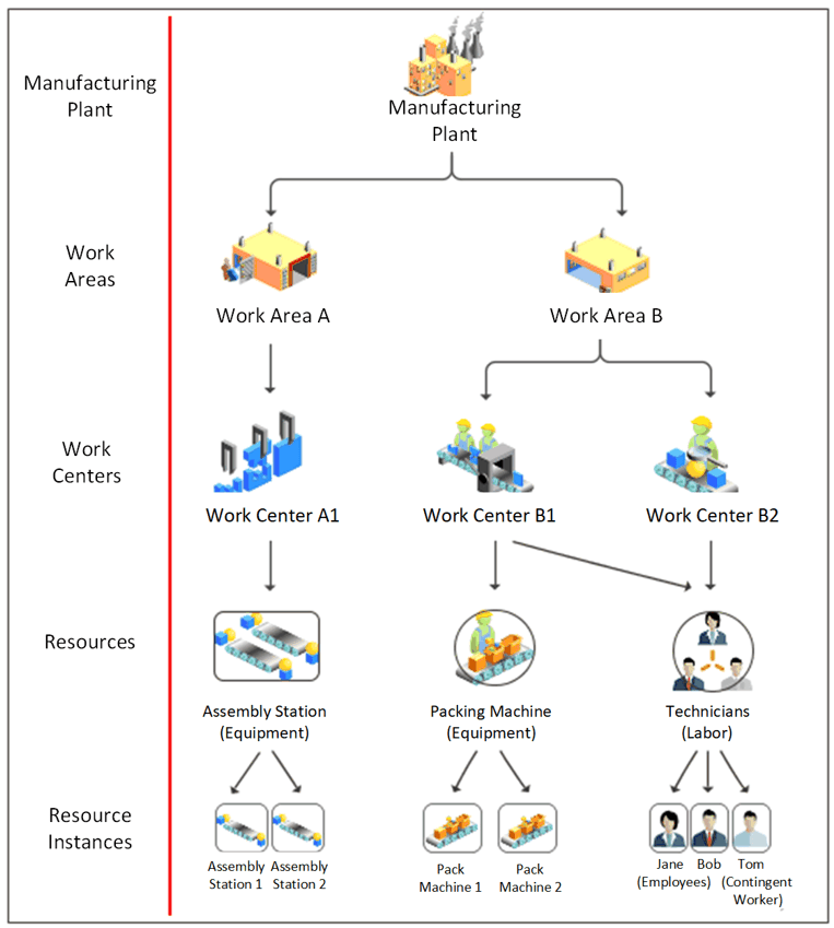

Manufacturing plants are made up of work areas, which comprise work centers, resources, and resource instances. Here's an illustration:
Figure 1 An illustration of a manufacturing plant.

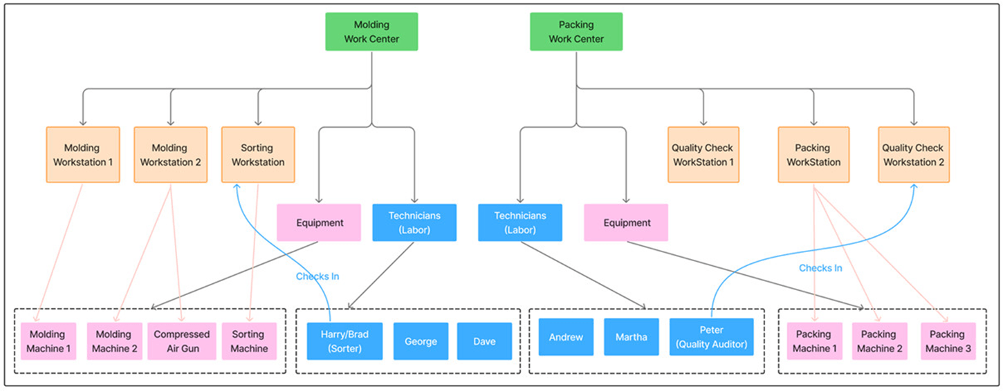

Add Workstations
Use workstations to assign locations in a work center where operators execute work order operations.
Operators execute work order operations at an assigned physical location, which can be a machine or a workbench. You can model this physical location as a workstation that is part of a work center, and associate equipment resource instances to perform in-house operations.
The following illustration shows workstations under the Molding and Packing work centers. Operators check into these workstations to execute work.

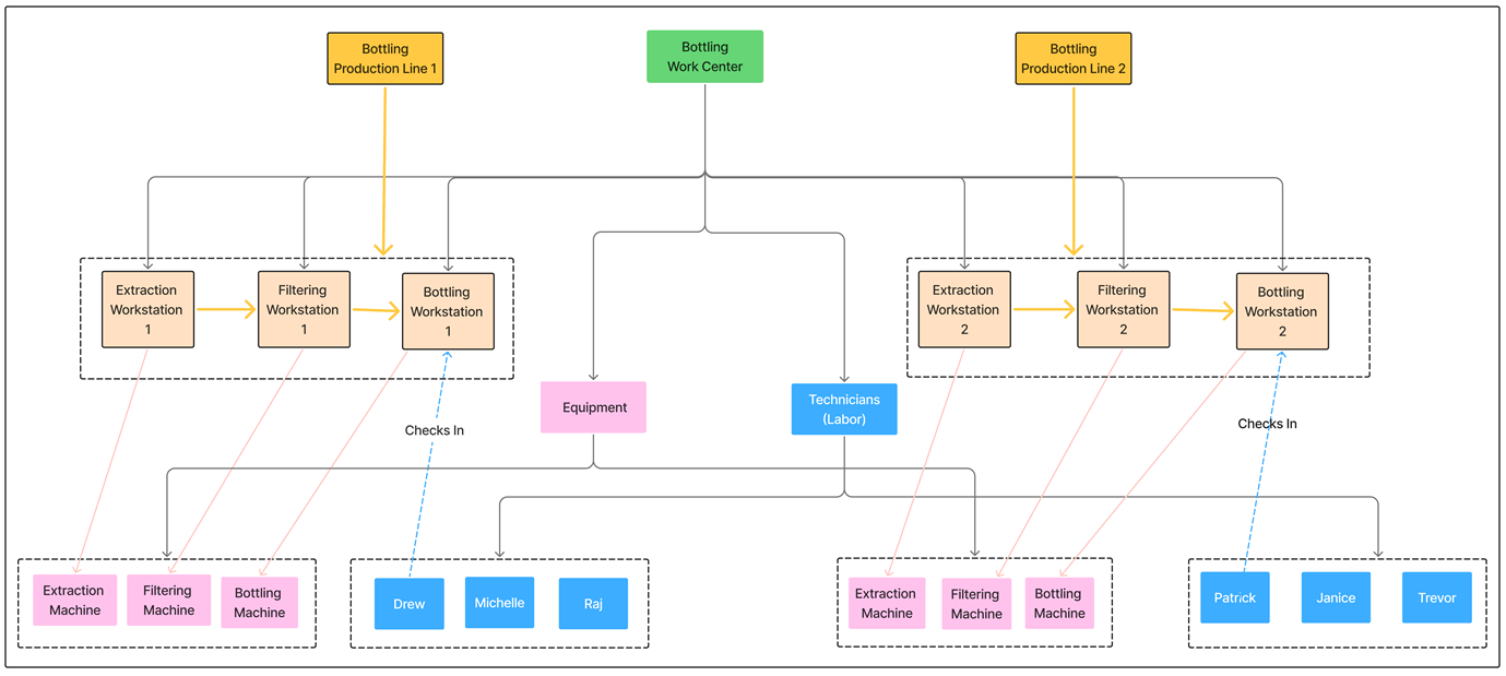

Add Production Lines
Production lines are commonly used in lean or flow manufacturing environments. They are used to produce a group of products that have similar manufacturing processes and belong to a product family. You can manage production lines to run flow manufacturing, which streamlines rate-based production based on the line capacity and availability using the Redwood user experience.
The following illustration shows two bottling production lines with associated workstations and equipment for line operations.
