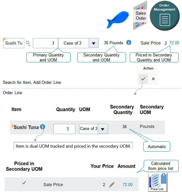

Create Sales Orders for Items That Use Dual Units of Measure
Add a dual UOM item to an order line, then use one unit of measure to track quantity and another unit of measure to track price.
Create an order, search for your item on the, then add it to an order line.
Note
  • You use the order line to search for the item. It displays the ordered quantity in the ordered UOM, and the secondary quantity in the secondary UOM. It also indicates whether Order Management priced the line in the secondary UOM.
  • You can't change the secondary quantity or secondary UOM on the order line, but you can change the primary quantity and Order Management will automatically calculate the secondary quantity and the amount.
Try it:
  1. Go to the Order Management work area and create a sales order:
    Attribute
    Value
    Customer
    Fancy Fish
    Business Unit
    Fresh Fish 4 U
  2. Search for the Sushi Tuna item on the order line.
    The order line sets the unit of measure to the primary, by default. It also displays primary and secondary attributes which makes it easy to see the conversion.
    For this example, assume you change the Quantity to 3 and the UOM to Case of 3:
    Attribute
    Value
    Quantity
    3
    This is the primary quantity.
    UOM
    Case of 3
    The primary UOM is Each. You can change this attribute to any UOM that's in the same class as the primary UOM, such as Case of 3.
    Secondary Quantity
    36
    The order line uses conversion rules that your order administrator sets up to automatically calculate the secondary quantity:
    • 1 case contains 3 tuna.
    • 1 tuna equals 4 pounds.
    • 3 tuna multiplied by 4 pounds means each case weighs 12 pounds.
    • 12 pounds for each case multiplied by the primary quantity of 3 equals a secondary quantity of 36.
    Secondary UOM
    Pounds
    Sale Price
    2
    Line Price
    72.00
    Its the secondary quantity of 36 pounds multiplied by the unit price of 2 equals 72.00.
    Information Icon
    Let's you know that the item is a dual UOM item.
  3. Click Add, then notice that the sales order adds the values that you set on the order line to the order line. Here are a few more details you should take note of:
    Attribute
    Value
    Item
    Contains your dual UOM item.
    Priced in Secondary UOM
    Value:
    • Selected. Pricing priced the order line according to the value in the Secondary UOM attribute on the order line. In this example, that would be Pounds.
    • Not Selected. Pricing priced the order line according to the value in the UOM attribute on the order line. In this example, that would be Each.

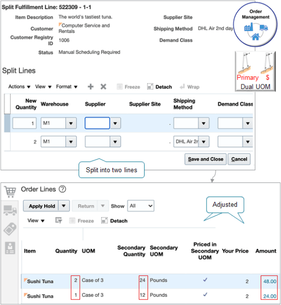

Split a Line
You can split a line that has a dual UOM item just like you split any other line.
Let's say your order line currently has a quantity of 3, you receive a request to expedite shipment for a quantity of 2, so you need to change the shipping method to 2nd day air. Here's what that looks like:
You split the line into two lines, one with a quantity of 1 and the other with a quantity of 2.
Note
  • You start with an order line that has these values:
    Attribute
    Value
    Item
    Sushi Tuna
    Quantity
    3
    UOM
    Case of 3
    Secondary Quantity
    36
    Secondary UOM
    Pounds
    Priced in Secondary Quantity
    Selected
    Your Price
    2
    Amount
    72.00
  • You split the line into two lines, one with a quantity of 1 and the other with a quantity of 2.
  • The split line action proportionally calculates the secondary quantity according to the quantity that you split.
  • If Order Management prices the item according to the secondary unit of measure, then it calculates the extended amount on the line proportionally distributed in the ratio in which the secondary quantity was split.
  • Here are the revised values on the split lines:
    Line
    Quantity
    Secondary Quantity
    Amount
    1-1
    2
    24
    48.00
    1-2
    1
    12
    24.00
Here's the math:
  • Line 1. Multiply the Quantity of 2 by the Secondary Quantity 24 equals Amount 48.00
  • Line 2. Multiply the Quantity of 1 by the Secondary Quantity 24 equals Amount 24.00
For details about how to split a line, see Split Order Lines.
