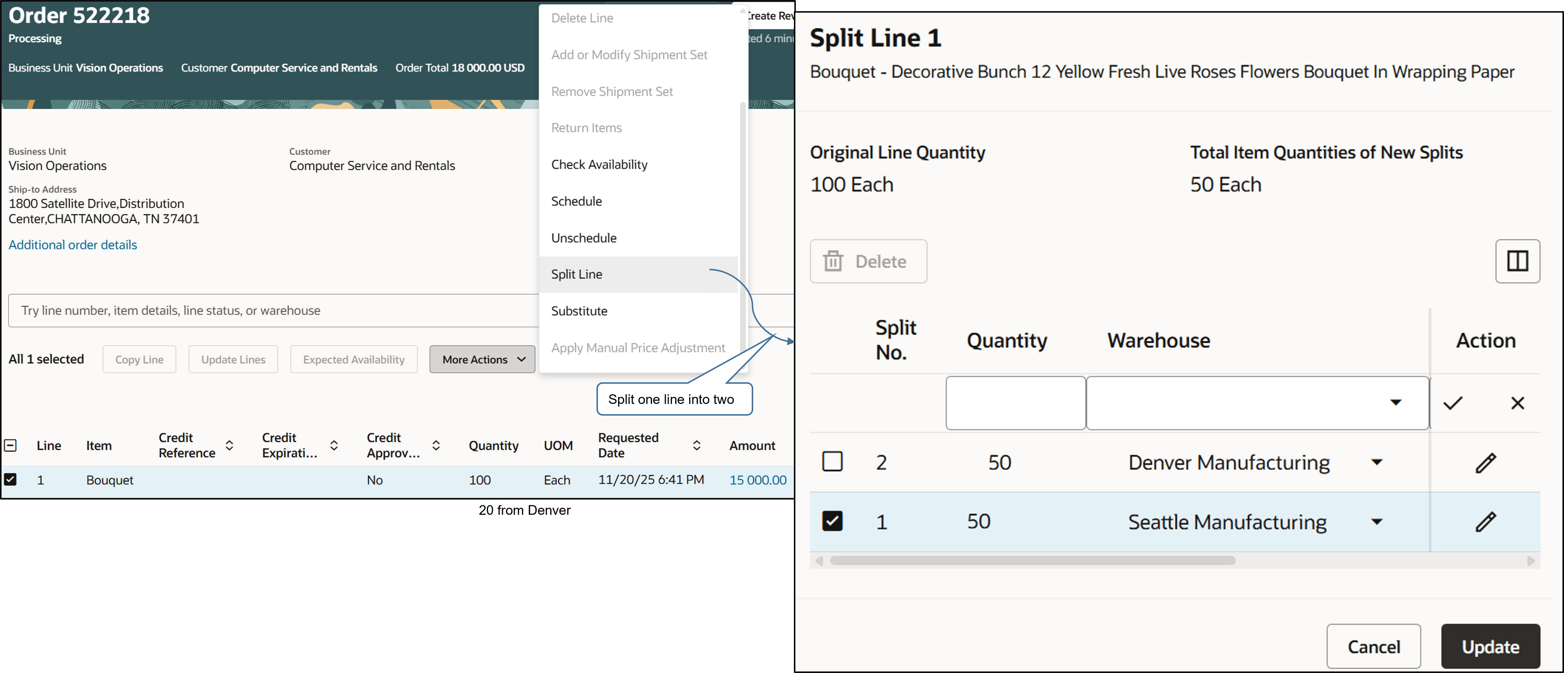

Splitting an order line is a supply chain technique that you can use to fulfill your sales order in a timely and efficient way. Assume your order line includes a quantity of 50 for the TABLET item, but the preferred Denver warehouse only has a quantity of 30 in stock. The Seattle warehouse has 40. To avoid a delay, you can split the line so it gets the quantity it needs from Denver and Seattle:
