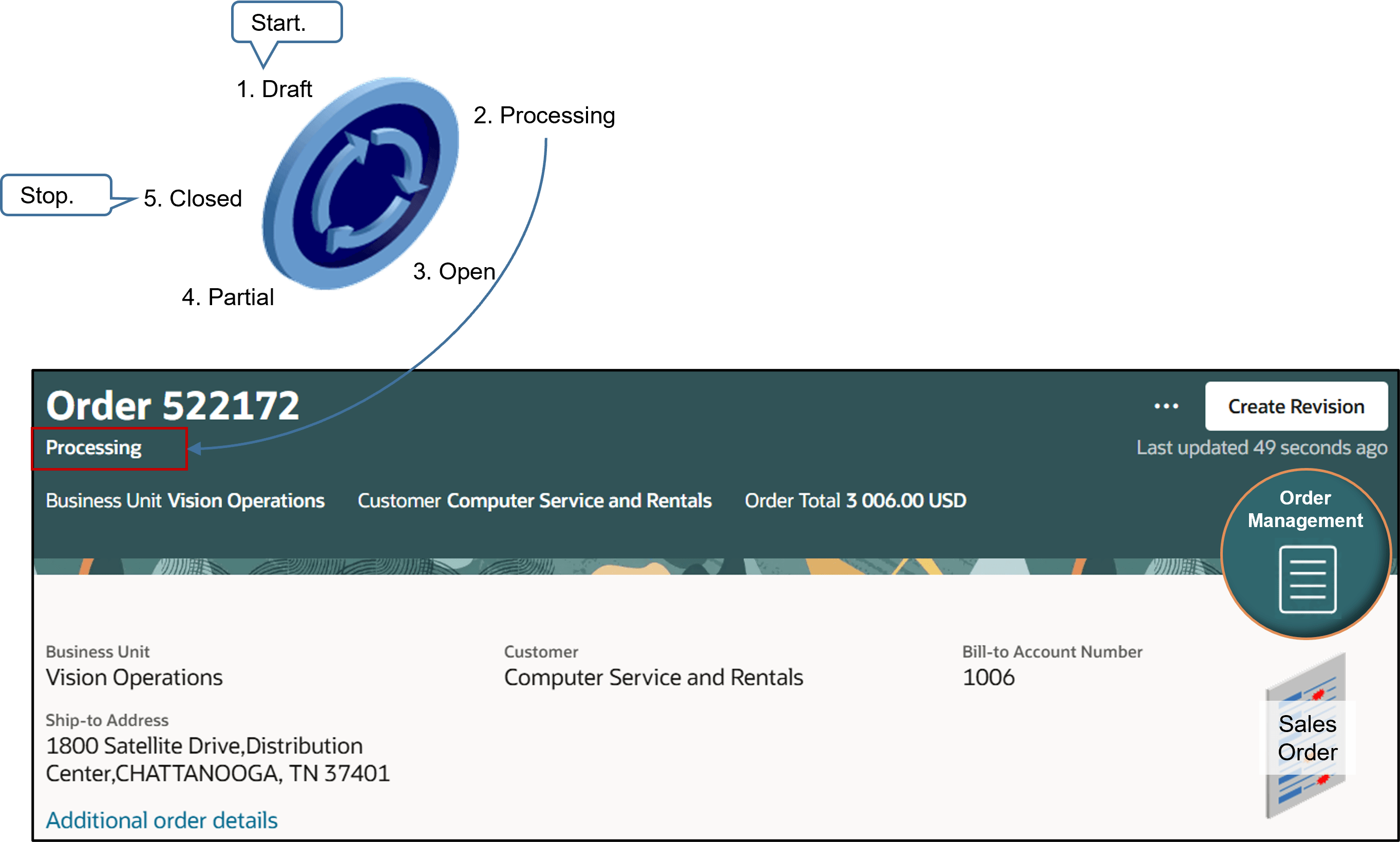

Sales Order Status
Your sales order goes through this sequence:
general sequence your sales order goes through.
Sales order status depends on the order line status:
Sequence
Sales Order Status
Description
1
Draft
You clicked Save to save the order to the database but haven't clicked Submit to submit it to order fulfillment. You can modify a Draft order.
Draft displays only if you click Save. If you create a sales order without saving it, but submit instead, then the status goes to Processing.

Order Status
At the top of the order page in the order title.
For example, the order status of this sales order is Processing.
