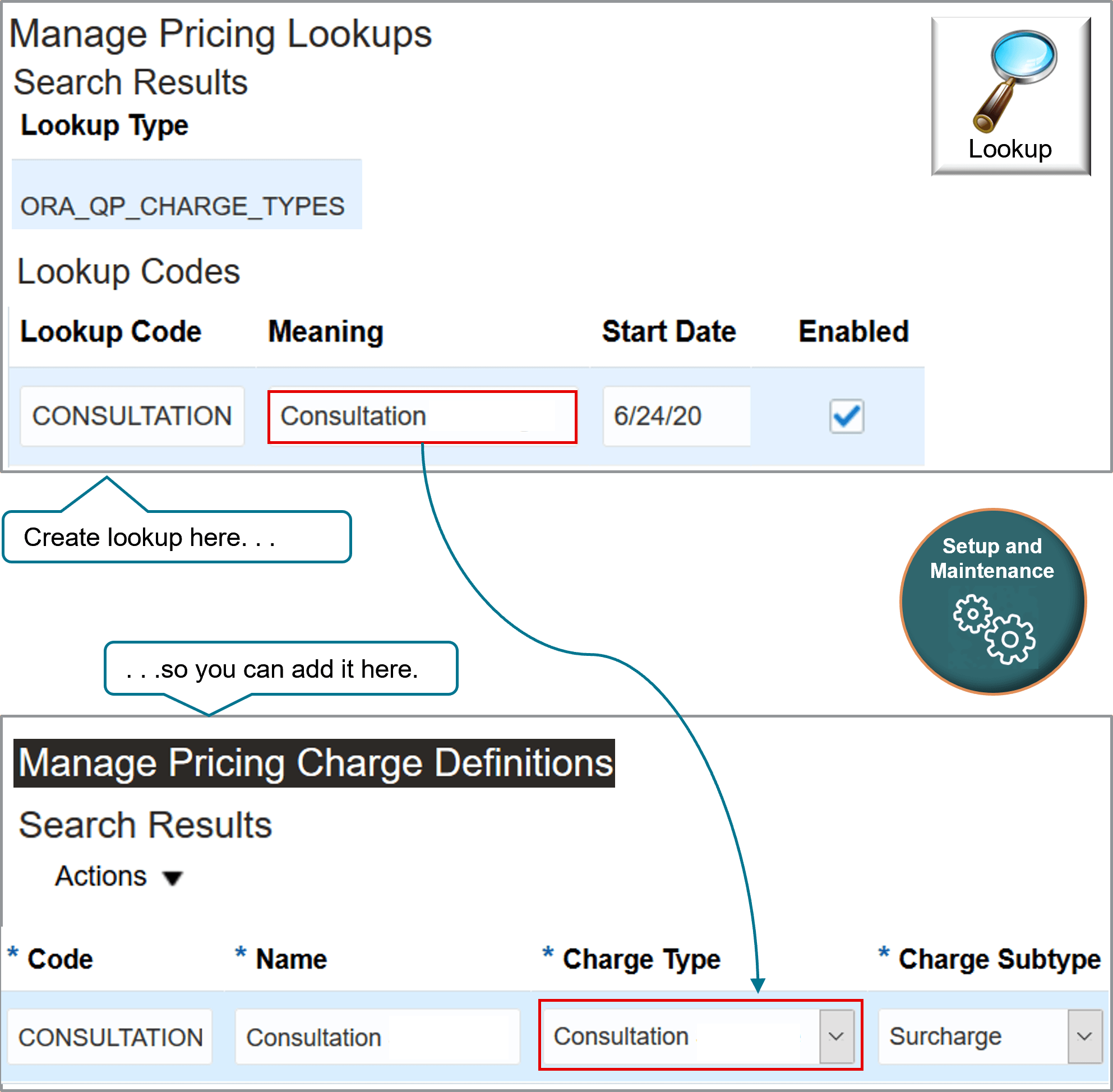

Add Your Own Lookup to Charge Types
Use the Manage Pricing Lookups page to add your lookup to a charge type, then select that lookup when you set up a charge definition on the Manage Pricing Charge Definitions page.
Use Manage Pricing Lookups page to add lookup to a charge type, select that lookup when you set up a charge definition on the Manage Pricing Charge Definitions page.

Assume you provide a site consultation for some customers. Your policy is to add a surcharge to the purchase price to cover the costs you incur to do the consultation. So you need to create a new charge definition for the consultation surcharge, a new charge type for the consultation, and a new charge subtype for the surcharge.
Create the charge type and charge subtype:

Create your charge definition:
  1. On the setup page, go to the Manage Pricing Charge Definitions task.
  2. On the Manage Pricing Charge Definitions page, click Actions > Add Row, then set the values:
    Attribute
    Value
    Code
    CONSULTATION
    Name
    Consultation
    Applies To
    Price
    Price Type
    One Time
    Charge Type
    Consultation
    This is the charge that you created on the Manage Pricing Lookups page.
    Charge Subtype
    Surcharge
    This is the charge subtype that you created on the Manage Pricing Lookups page.
  3. Click Save and Close.
