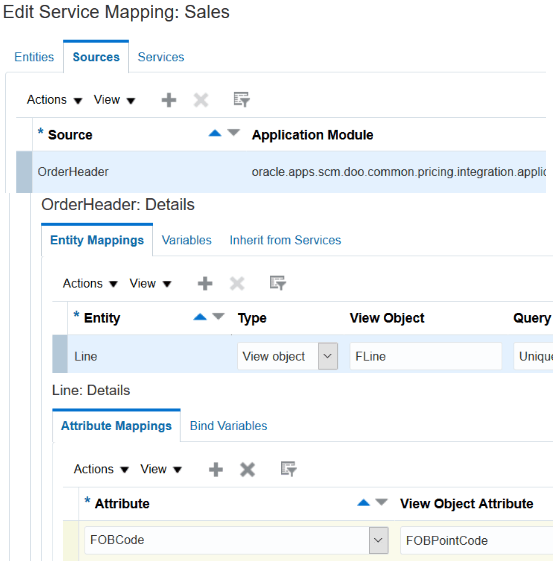

Set Up the Service Mapping
Set up the service mapping:
  1. Sign out of Order Management, and then sign back in as the pricing manager.
  2. Go to the Pricing Administration work area, then click Manage Service Mappings under Pricing Configuration.
  3. On the Manage Service Mappings page, click the row that includes the value:
    Attribute
    Value
    Name
    Sales
  4. Map the attribute to the order header:
    • On the Edit Service Mapping page, click Sources, then click the row that includes the value:
      Attribute
      Value
      Source
      OrderHeader
    • In the OrderHeader Details area, on the Entity Mappings tab, click the row that includes the value:
      Attribute
      Value
      Entity
      Line
    • In the Line Details area, on the Attribute Mappings tab, click Actions > Add Row, then set the values:
      Attribute
      Value
      Attribute
      FOBCode
      View Object Attribute
      FOBPointCode
      For example:
