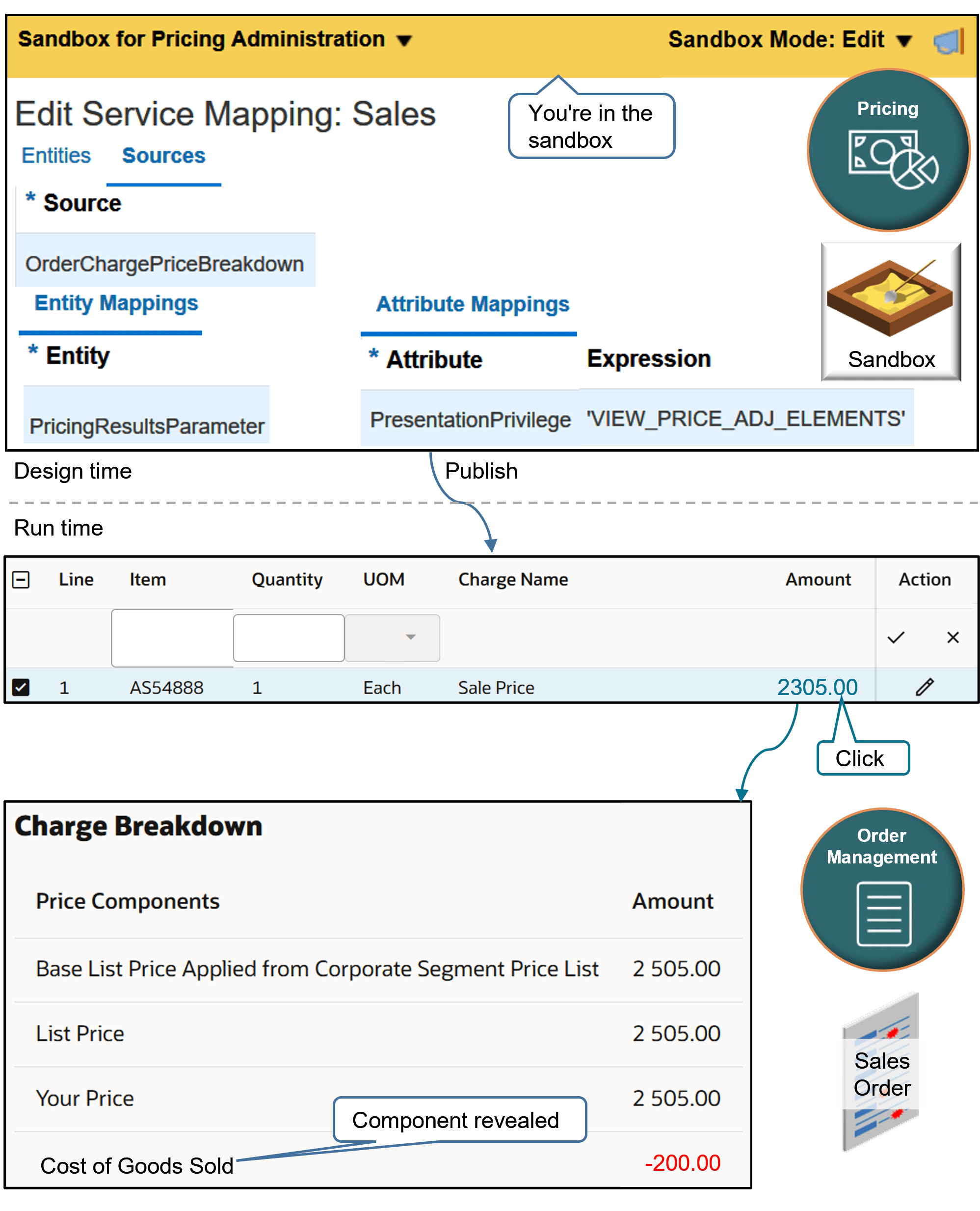

    A yellow banner displays at the top of the page to indicate that you're in the sandbox:
    Modify the Sales service mapping so Order Management displays cost and margin in the charge breakdown on the order line.
