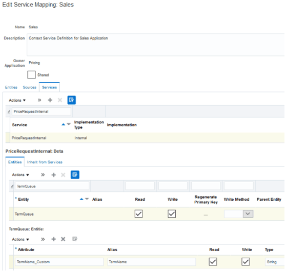

Modify Service Mapping for Simple Discount
Here are the modifications that you make in the Sales service mapping:
TermQueue entity of the PriceRequestInternal service
You add the TermName_Custom attribute to the TermQueue entity of the PriceRequestInternal service.
If you need to add your discount on a tier adjustment, then use the TierLineQueue entity instead of the TermQueue entity. If you need to apply a discount according to an attribute, see Add Your Own Attributes to Items in Pricing:
  1. In the Details area, in the Entities tab, click the row that includes the value:
    Attribute
    Value
    Entity
    TermQueue
  2. In the Details area, click Actions > Add Row, then set the values:
    Attribute
    Value
    Entity
    TermQueue
    Read
    Contains a check mark.
    Write
  3. In the Entities area, click View > Columns > Show All, click Actions > Add Row, set the values, then click Save:
    Attribute
    Value
    Attribute
    TermName_Custom
    Alias
    TermName
    Read
    Write
    Type
    String

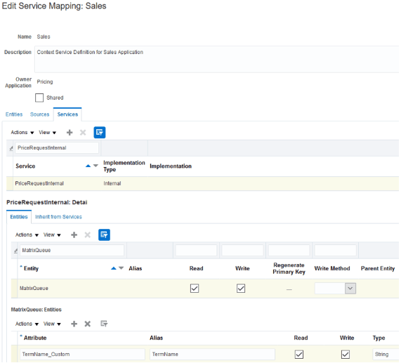

Modify Service Mapping for Discount According to Attribute
MatrixQueue entity of the PriceRequestInternal service
You add the TermName_Custom attribute to the MatrixQueue entity of the PriceRequestInternal service.
    Attribute
    Value
    Entity
    MatrixQueue
    Attribute
    Value
    Entity
    MatrixQueue
    Read
    Write
  3. In the Entities area, View > Columns > Show All, click Actions > Add Row, set the values, then click Save:
    Attribute
    Value
    Attribute
    TermName_Custom
    Alias
    TermName
    Read
    Write
    Type
    String

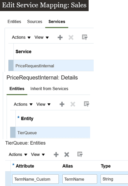

Modify Service Mapping for Tier Adjustments
You will add the TierQueue entity.
Try it:
  1. Click Tasks > Manage Service Mappings under Pricing Configuration.
  2. On the Manage Service Mappings page, in the Name column, click Sales.
  3. On the Edit Service Mapping page, click Services.
  4. Click Query By Example, then query for PriceRequestInternal.
  5. In the PriceRequestInternal Details area, on the Entities tab, click Query By Example, then query for TierQueue.
  6. In the TierQueue Entities area, click View > Columns, then make sure Type contains a check mark.
  7. Click Actions > Add Row, then set the values:
    Attribute
    Value
    Name TermName_Custom
    Alias TermName
    Type String
  8. Click Save and Close.

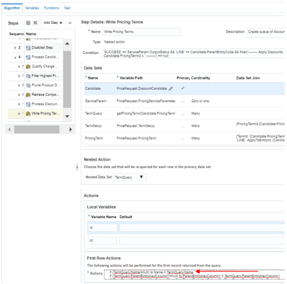

  5. On the Edit Algorithm page, expand the steps until you locate the Write Pricing Term Rules step.
  6. Click the row that includes Write Pricing Term Rules in the Name column.
  7. In the Step Details area, in the First Row Actions area, locate this code:
    //if (TermQuery.Name!=null) ts.Name = TermQuery.Name
  8. Remove the forward slashes ( // ) from the code.
    For example:
    This step instructs the algorithm to examine the TermQuery attribute that you set up in the service mapping earlier in this topic.
  9. Click Save and Close > Actions > Publish.

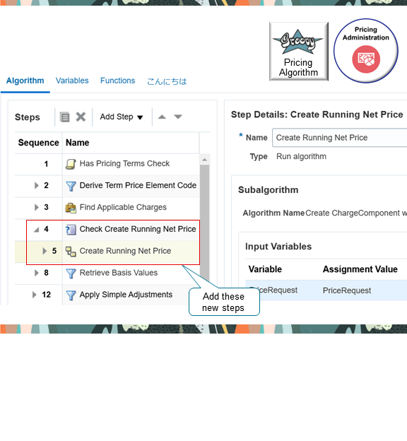

  7. In the Steps area, click the row that says Queue Terms Against Lines in the Name column.
  8. Add the step that creates the running net price:
    • Click Add Step > Composite Step, then click If.
      Here's the step that you add.
      adding step to the algorithm
    • In the Step Details area, set the values, then click Save:
      Attribute
      Value
      Name
      Check Create Running Net Price
      Condition
      'DISCOUNT_LINE' == TermType
      You must include the single quotation marks (' ).
    • In the Steps area, expand the row you just created, Check Create Running Net Price.
    • Click Add Step > Subalgorithm.
      You can add a condition only on the step. So, you create the step, then add the subalgorithm that specifies the pricing algorithm to run and the variable to send to this algorithm.
    • In the Step Details area, set the values:
      Attribute
      Value
      Name
      Description
      This step creates a charge component for a running net price.
      Algorithm Name
      Create ChargeComponent with RunningUnitPrice
    • In the Input Variables area, set values:
      Variable
      Assignment Value
      PriceRequest
      PriceRequest
      PriceElementCode
      RunningNetPriceElem
      IsForCeilingPrice
      BaseCeilingPriceElementCode
      Don't use these variables. They are for Oracle internal use only.
      RoundingAdjustmentElementCode
      'QP_ROUNDING_ADJUSTMENT'
      PerformRounding
      false
      IsForMargin
      false
      PriceElementUsageCode
      Leave empty
      ChargeAppliesToCode
      'PRICE'
      RoundingAdjustmentElementUsageCode
      'PRICE_ADJUSTMENT'
    • In the Output Variables area, set the value:
      Variable
      Assignment Value
      PriceRequest
      PriceRequest

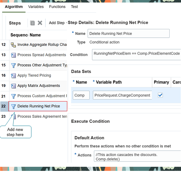

  9. Add the step that deletes the running net price.
    Add the step:
    • Click the step that has Process Custom Adjustment Flag in the Name column.
    • Click Add Step > Conditional Action, then set the values:
      Attribute
      Value
      Name
      Delete Running Net Price
      Description
      This step deletes a charge component for a running net price.
      Condition
      RunningNetPriceElem == Comp.PriceElementCode
    • In the Data Sets area, click Add Row, then set the value:
      Name
      Variable Path
      Primary
      Comp
      PriceRequest.ChargeComponent
    • In the Execute Condition area, click Add Condition > Default Action, then set the value:
      Attribute
      Value
      Action
      //This action cascades the discounts. Comp.delete()
    • Click Save.

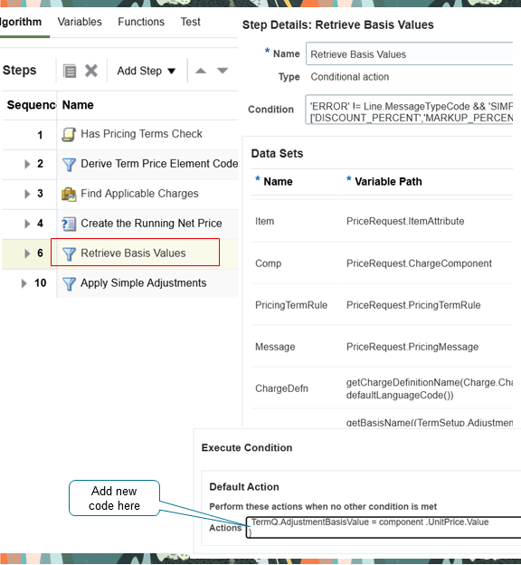

  10. Make sure the algorithm applies your rules in the sequence that you expect. Do this step when your discount list has more than one rule:
    • Click the step that has Process Other Adjustment Types in the Name column.
    • In the Conditional Actions area, in the Then Perform These Actions column, click the pencil.
    • In the Edit Actions dialog, notice the code.
      finer('\tSetting up queue for applying discount matrix '+TermSetup.AttributePricingMatrixId)
      mq = MatrixQ.insert([ParentEntityCode:'CHARGE', ParentEntityId:TermQ.ChargeId])
      mq.DynamicMatrixId = TermSetup.AttributePricingMatrixId
      mq.ApplyToRollupFlag = ('Y' == TermSetup.ApplyToRollupFlag)
      mq.FromCurrencyCode = TermSetup.PricingCurrencyCode

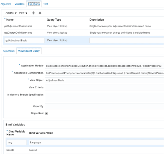

  1. Add a function:
    • Click Functions.
      Here's the function that you will add:
      view object that the pricing algorithm can use in a function that gets the adjustment basis
      You add a view object that the pricing algorithm can use in a function that gets the adjustment basis.
    • Click Actions > Add Row, then set the value:
      Name
      Query Type
      getAdjustmentBasis
      View Object Lookup
    • In the Arguments area, add the arguments:
      Name
      Comments
      BasisId
      Value that identifies the adjustment basis.
      Language
      Abbreviation that identifies the language.
    • Click View Object Query > Add Row, then set the values:
      Attribute
      Value
      Application Module
      oracle.apps.scm.pricing.priceExecution.pricingProcesses.publicModel.applicationModule.PricingProcessAM
      Application Configuration
      ${(PriceRequest.PricingServiceParameter[0]?.CacheEnabledFlag==null || PriceRequest.PricingServiceParameter[0].CacheEnabledFlag) ? 'PricingProcessAMShared' : 'PricingProcessAMLocal'}
      View Object
      AdjustmentBasis1
      Single Row
    • In the Bind Variables area, add the bind variables, then click Save:
      Bind Variable Name
      Bind Variable Value
      basisId
      BasisId
      lang
      Language
  2. Modify the step that gets values for the adjustment basis:
    • Click Algorithm.
    • In the Steps area, click the step that includes Retrieve Basis Values in the Name column.
    • In the Step Details area, in the Default Action area, scroll all the way to the end, and then locate this code:
      else {
        finer('\tFound '+component .PriceElementCode+' charge component '+component .ChargeComponentId+' with unit price '+component .UnitPrice.Value)
        TermQ.AdjustmentBasisValue = component .UnitPrice.Value
    • Add this line immediately before the closing curly bracket:
      //We're adding this line for cascading discounts:
      TermQ.TermName = TermSetup.Name
      For example:
      else {
      You add it here:
    • Click Save.

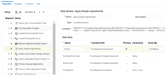

  3. Modify the step that applies the simple adjustment:
    • In the Steps area, click the step that includes Apply Simple Adjustments in the Name column.
    • In the Data Sets area, add the data sets:
      Name
      Variable Path
      Cardinality
      RunningPriceComp
      Many
      This value specifies to use many charge components for the running price to one term in the term queue.
      BasisComp
      Many
      This value specifies to use many pricing bases for the charge components to one term in the term queue.
    • In the Data Sets area, in the row that includes TermQ in the Name column, set the value:
      Attribute
      Value
      Order By
      TermName
    • In the Execute Condition area, in the Local Variables area, add the local variables:
      Variable Name
      Default
      BasisElementCode
      Leave empty.
      RunningPrice
      Leave empty.
