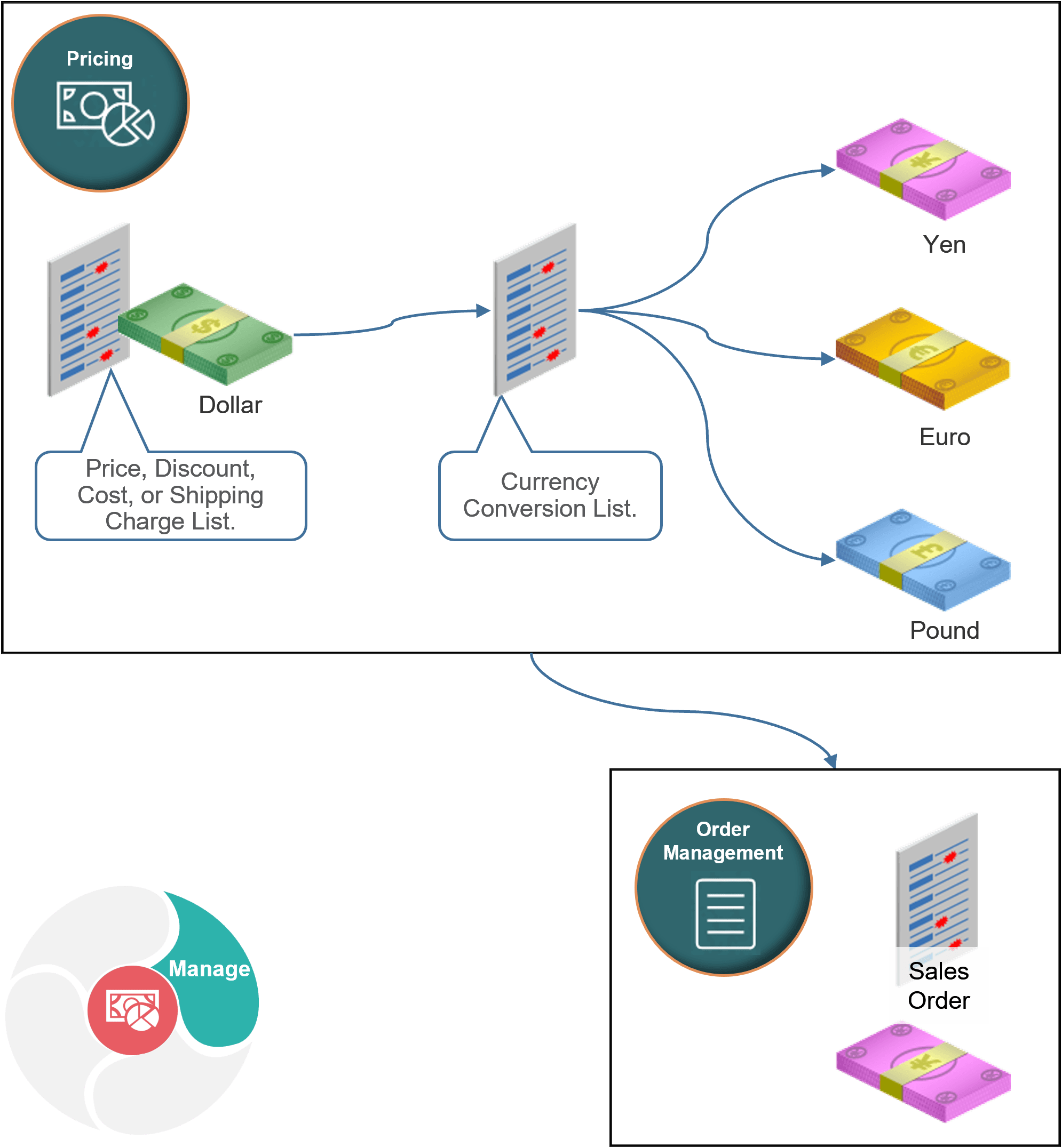

Set up a currency conversion list to specify the conversion rate that you want to use between two currencies, such as between the US Dollar and the Canadian Dollar.
Use a currency conversion list to manage currency.
Realize these benefits:
  • Do business in more than one currency while maintaining your pricing rules in one currency.
  • Set up price values in a single currency but offer items in more than one currency.
  • Adjust the conversion rate to accommodate changes that happen in company policy, currency fluctuations, international monetary policy, and so on.
  • Set up the currencies and conversion rules that Pricing uses to calculate price at run time so the application that needs price details, such as Order Management, can display prices in the currency that you're familiar with.
  • Create a currency conversion rule for each pricing strategy.
  • Create one price with more than one conversion type.
  • Create markups and markdowns for each currency or country.
  • Reduce maintenance because you create only a few lists in Pricing for a pricing strategy when compared to creating a price list for each currency.
