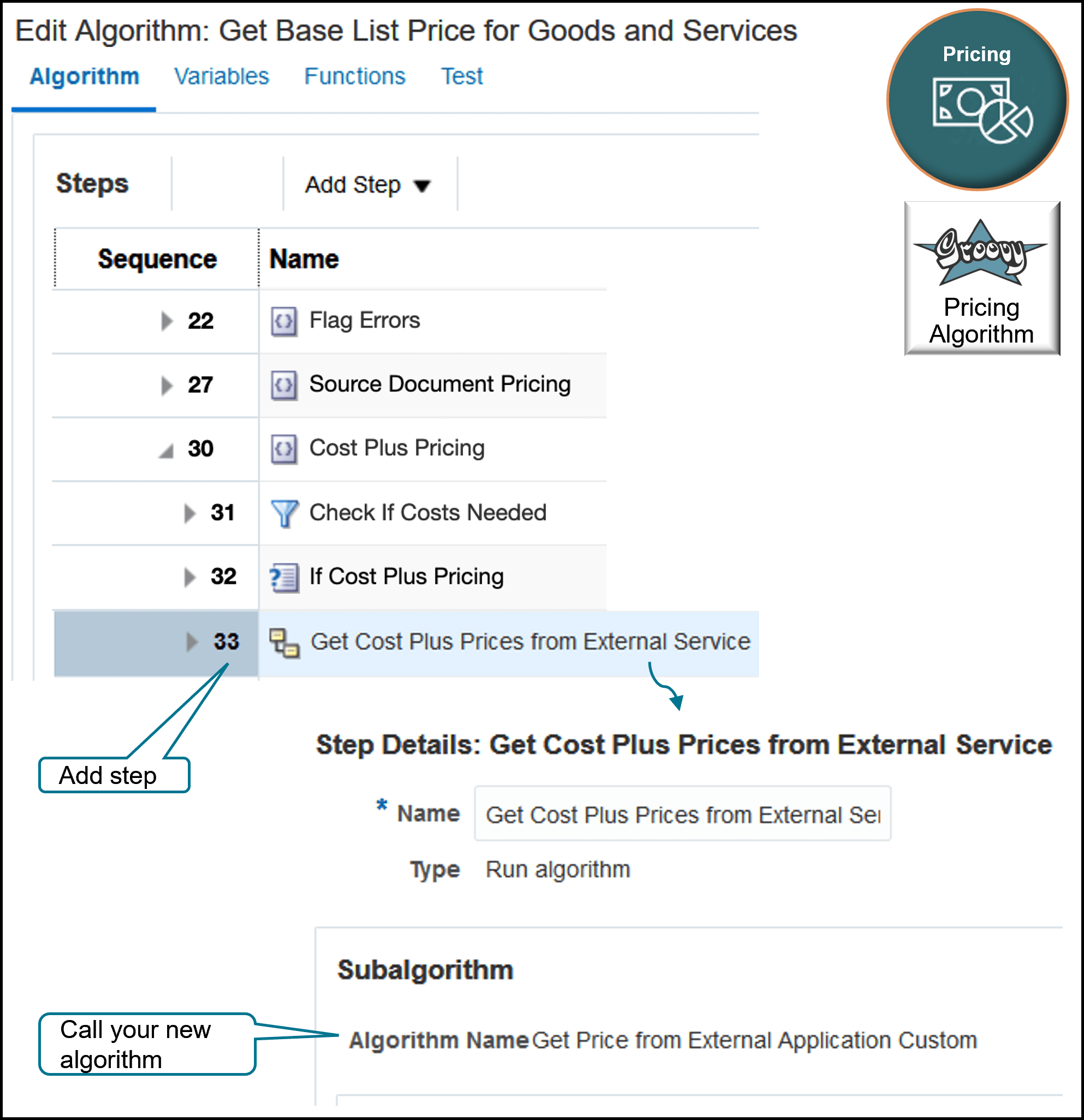

  3. Modify cost plus pricing:
    • Click the Cost Plus Pricing step.
    • Click Add Step > Composite Step > If.
    • Click the new step you just added and set the values:
      Attribute
      Value
      Name
      If External Costing Plus Pricing
      Condition
      NeedsCostPlus && finer('==== Invoking Cost-Plus Pricing ====') == null
    • Click Save.
  4. Add the subalgorithm:
    • In the tree, click the triangle on the step you just added, If External Costing Plus Pricing.
      This helps to make sure that the subalgorithm you add is a child of If External Costing Plus Pricing.
    • Click Add Step > Subalgorithm.
    • In the Step Details area, set the values:
      Attribute
      Value
      Name
      Compute Cost from External Systems
      Algorithm Name
      Get Price From External Application Custom
      This is the algorithm that you created in the previous section in this topic.
    • In the Input Variables area, set the values:
      Attribute
      Value
      Variable
      PriceRequest
      Assignment Value
      PriceRequest
    • In the Output Variables area, set the values:
      Attribute
      Value
      Variable
      PriceRequest
      Assignment Value
      PriceRequest
  5. Click Save and Close, then publish the highest version of Get Base List Price for Goods and Services.

  • Save and publish your changes.
Calculate Margin
As an option, you can calculate margin according to costs from Oracle Costing.
The Calculate Cost pricing algorithm calculates cost, and the Calculate Margin step in the Calculate Pricing Charges algorithm calculates the margin. This section describes some guidelines you can follow for this use case.
