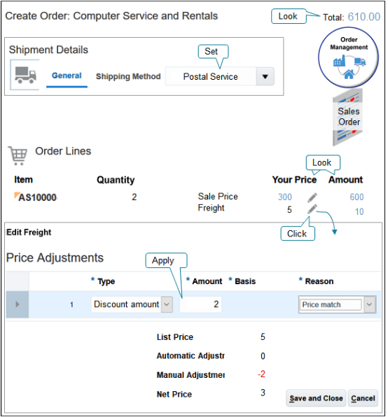

  1. Open your sales order in Order Management.
  2. Click Shipment Details, then set the Shipping method.
  3. Notice the order line.
  4. Notice that the order line contains a charge for Freight of $5 each, and an extended value in the Amount column of 10 because Quantity is 2.
  5. Notice the order total is $610.
  6. Click the value in the Amount column.
  7. In the Price Adjustments dialog, add an amount discount for $2, set Reason to Price Match, then save your work.:
    Note

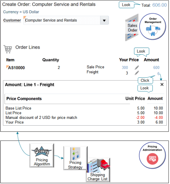

    • The value for Freight is now 3.
    • The extended value in the Amount column is now 6.
    • The order total is $606.

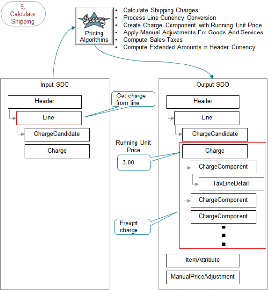

Here are the SDOs:
the SDOs for this section
Note
  • The output SDO from the Calculate Cost and Margin step provides the input SDO.
  • The algorithms store details in charge components in the freight charge on the output SDO. They use a separate component for each of:
    • Base list price
    • List price
    • Manual adjustments
    • Net price
    • Exclusive tax
    • Net price plus tax
Here's what the algorithms do:
What the Algorithms Do
How the Algorithms Do It
1. Get shipping charge lists.
Examine the shipping charge list that the pricing strategy references. Make sure it includes at least one charge for the item.
Calculate the shipping charge for each order line.
2. Convert currency on the order line.
If the shipping charge list doesn't use the same currency that the sales order uses, then convert it so it does use the same currency.
For example, if the sales order uses RMB but the shipping charge list uses USD, then covert USD to RMB on the shipping charge list.
3. Create candidates for shipping charges.
Create a separate candidate for each shipping charge that the shipping charge list specifies.
Pricing doesn't come predefined to apply flat rate shipping charges. The predefined set up only applies shipping charges for each item.
4. Create charge components for the base list price.
Create a charge component for each shipping charge on the order line according to the base list price that the shipping charge list specifies.
5. Create charge component for the list price.
Create a charge component for each shipping charge on the order line according to the list price that the shipping charge list specifies.
6. Apply manual adjustments.
If the Order Entry Specialist applies a manual adjustment to the shipping charge on the sales order, then the algorithm creates and calculates the charge components it needs to apply the adjustment. It does this for each adjustment that you apply.
7. Create charge component for the net price.
8. Calculate tax.
Apply tax rates to the charges.
9. Calculate currency amounts for the order header.
Calculate the order total. Use the currency that the sales order specifies.
