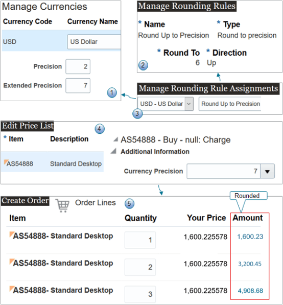

  1. Use the Manage Currencies task to set precision for the currency:
    • Use the Precision attribute to specify the number of decimal places to the right of the decimal point.
    • Use the Extended Precision attribute when you need even more precision. It also specifies the number of decimal places to the right of the decimal point, but you can set Extended Precision to a higher value.
  2. Use the Manage Rounding Rules task to set precision for rounding.
  3. Use the Manage Rounding Rule Assignments task to assign currency to the rounding rule.
  4. Use the Price List page to edit the charge for your item on the price list and to set the currency precision for the charge.
  5. Create a sales order and see how Pricing applies your set up at run time:
    • The Extended Precision attribute that you set on the currency affects the Your Price attribute on the order line. In this example, it's six decimal places, rounded up from 36.2255779.
    • The Currency Precision attribute that you set on the charge affects the Amount attribute on the order line.
    • Pricing starts with the Base List Price attribute on the price list, uses your rounding rule to round the value, then applies other set ups that you have for the item, such as discounts, other charges, and so on.
Assume you sell the AS54888 Desktop Computer in the USD currency. You need to round the USD currency with a precision of 2, extended precision of 7, and round it up according to a precision of 6.
Try it:
  1. Go to Home > My Enterprise > Setup and Maintenance > Tasks > Search > Manage Currencies.
  2. On the Manage Currencies page, search for the value:
    Attribute
    Description
    Currency
    USD
  3. Expand the row in the search results.
  4. Set the values, then click Save and Close:
    Attribute
    Description
    Precision
    2
    Extended Precision
    7
  5. Go to the Manage Rounding Rules task.
  6. On the Manage Rounding Rules page, click Actions > Add Row.
  7. Set the values, then click Save and Close:
    Attribute
    Description
    Name
    Round Up to Precision
    Type
    Round to Precision
    Round To
    6
    Direction
    Up
    Setup Enabled
    Active
    Contains a check mark.
  8. Go to the Manage Rounding Rule Assignments task.
  9. On the Manage Rounding Rule Assignments page, click Actions > Add Row.
  10. Set the values, then click Save and Close:
    Attribute
    Description
    Currency
    USD
    Rounding Rule
  11. Create a charge:
    • Make sure you have the privileges that you need to administer pricing.
      Go to the Pricing Administration work area.
    • Click Price Lists.
    • On the Price Lists page, search for and open the Corporate Segment Price List.
    • On the Price List page, in the search results, click Actions > Add Row, then set the values:
      Attribute
      Description
      Item
      AS54888
    • Click Create Charge.
    • In the AS54888 Charge area, expand Additional Information, then set the values:
      Attribute
      Description
      Currency Precision
      7
    • Click Save and Close.
  12. Test your set up:
    • Go to the Order Management work area, create a sales order, then add 3 order lines:
      Order Line
      Item
      Quantity
      1
      AS54888
      1
      2
      AS54888
      2
      3
      AS54888
      3
    • Verify the price and amount for the AS54888 item. Assume that Your Price is $36.225578:
      Quantity
      Amount
      1
      $36.23
      Here's the calculation:
      1. Multiply 36.225578 by a quantity of 1 equals 36.225578.
      2. Round 36.225578 up according to a decimal precision of 2, equals 36.23.
      2
      $72.45
      1. Multiply 36.225578 by a quantity of 2 equals 72.451156.
      2. Round 72.451156 up according to a decimal precision of 2, equals 72.45.
      3
      $108.68
      1. Multiply 36.225578 by a quantity of 3 equals 108.676734.
      2. Round 108.676734 up according to a decimal precision of 2, equals 108.68.
      Your Price is six decimal places, rounded up from 36.2255779.
