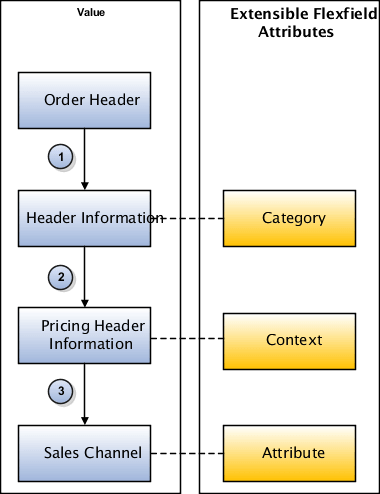

Define the Extensible Flexfield
Here's the hierarchy you set up for your extensible flexfield:
hierarchy for your extensible flexfield
Note
Reference
Description
1. The Order Header references the Header Information flexfield category.
Not applicable
2. The Header Information flexfield category references the Pricing Header Information flexfield context.
A category is an organizing structure that you use to dynamically display different sets of pages and contexts at run time.
In this example, you create a single category for a flexfield so Order Management displays the same extensible flexfield context for each sales channel.
3. The Pricing Header Information flexfield context references the Sales Channel attribute.
An extensible flexfield context is a group of attributes that you use to arrange segments into meaningful groups.
For example, the Order Management work area displays each context in the same area on a page at run time.

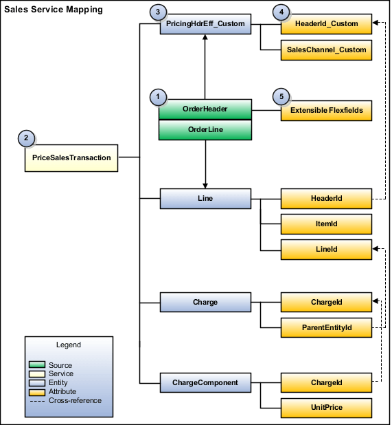

Administer the Service Mapping
Administer the service mapping that implements this SDO:
SDO for the service mapping
Here are the objects that this SDO contains:
Object
Your Work in This Example
1. Source. Provides a structure so Pricing can model data in the input SDO.
You specify the OrderHeader source on the predefined Sales service mapping. You map this source to the PricingHdrEff_Custom entity, then map the SalesChannel_Custom and HeaderId_Custom attributes to this entity.
2. Service. Requests the service mapping and receives the output SDO.
The PriceSalesTransaction service references the entities and attributes that the pricing algorithm uses to calculate the product price of each sales order.
3. Entity. References the entities that the service mapping requires to structure the output SDO.
You add the PricingHdrEff_Custom entity to the Sales service mapping.
4. Attribute. References the attributes that the service mapping requires to structure the output SDO.
You add the HeaderId_Custom attribute and SalesChannel_Custom attribute.
5. Extensible flexfields. Contains the data that this example uses.
You map the extensible flexfields that you created earlier in this topic. You map them as attributes of the PricingHdrEff_Custom entity on the OrderHeader source.
Learn about SDOs. For details, see How Service Mappings, Pricing Algorithms, and Matrixes Work Together.
