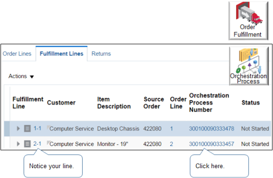

In this example, click Manage Orders, then search for and open a sales order:
  1. Use the fulfillment view to monitor and manage order fulfillment. It displays the results of the order transformation, such as the order lines and orchestration processes that Order Management added to fulfill your sales order.
  2. On the Fulfillment Lines tab, notice that Order Management added a separate order line for each order line you created, and that each order line includes details about the order status and orchestration process:
    separate order line for each order line that you created, and each order line includes information about the order status and orchestration process

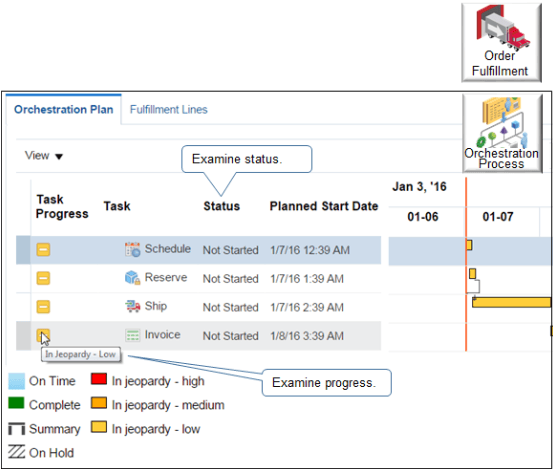

  3. Click an orchestration process number, such as 300100090333478.
  4. On the Orchestration Plan tab, examine the fulfillment tasks that the orchestration process scheduled to fulfill the order line, and the current status of each fulfillment task.
    Here's an example where the jeopardy is low for each fulfillment task:
    Note
    • None of the tasks have started.
    • The orchestration process might not start a fulfillment task for a number of reasons, such as the Planned Start Date hasn't happened, the Earliest Acceptable Ship Date might happen too far in the future, or other sales orders might have higher priority.
    • For details, see Fix Problems and Improve Performance.

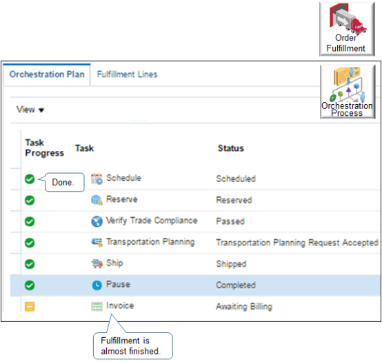

Here's an example orchestration plan that has completed all fulfillment tasks for the sales order up to the Invoice fulfillment task, and is now waiting for billing to invoice the sales order:
A check mark indicates that the fulfillment task finished. Your orchestration plan might display different fulfillment tasks and task statuses, depending on how your order administrator sets up Order Management.
