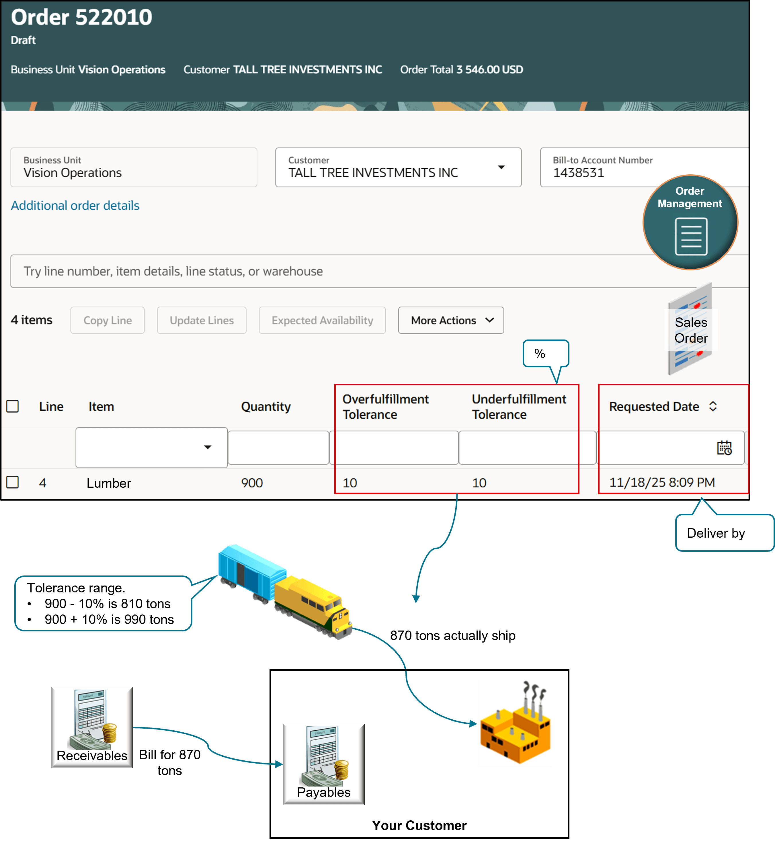

Example
Assume you work for Green Corp, a sustainable forestry company that uses railroads to ship a bulk material, such as raw timber that you haven't kiln dried or milled. Your customer orders a quantity of 900 tons:
Assume you work for Green Corp, a sustainable forestry company that uses railroads to ship a bulk material, such as raw timber that you haven't kiln dried or milled. Your customer orders a quantity of 900 tons.
Note
  • You plan to ship the order on train cars that have a maximum capacity of 100 tons each.
  • You must reserve the cars weeks in advance, the railroad charges you for each car, so you prefer to fill them as close to capacity as possible. But there's a significant variation in the amount of lumber you can get on a single car because moisture content varies from season to season and year to year, and moisture content affects weight. Even the location where you source the lumber affects the weight of your item, such as the wet Pacific Northwest compared to the drier Rocky Mountains.
  • Given these factors, its nearly impossible to accurately and consistently predict weight or volume, so you arranged an agreement with your customer to deliver quantity within a range that you and your customer can tolerate.
  • The agreement is to ship with a 10% over shipment tolerance and 10% under shipment tolerance.
  • 10% of 900 is 90, so you can ship between 810 tons (900 minus 90) and 990 tons (900 plus 90) and remain within the tolerance.
  • The actual shipment ends up being 870 tons during fulfillment, which is an undershipment. Billing bills the customer for 870 tons.
