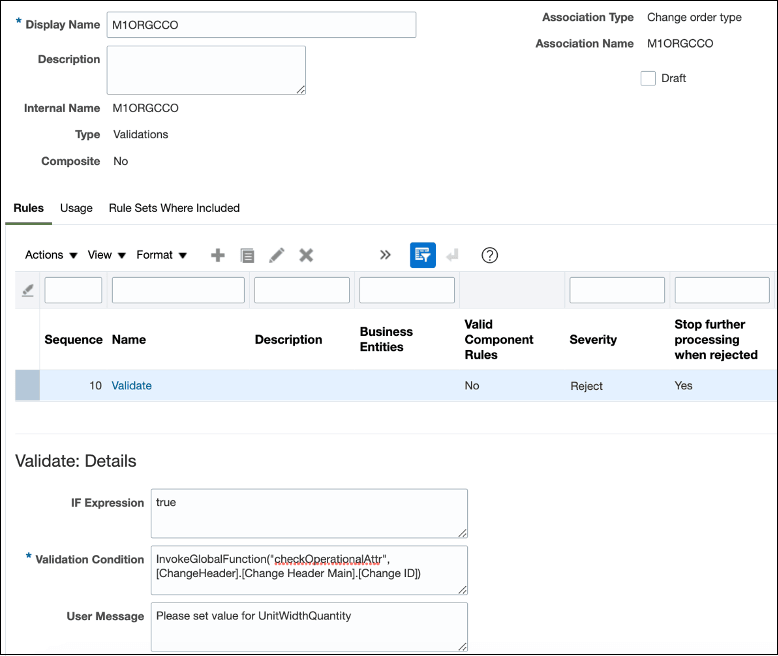

  3. Set up Item Rule in the Rules tab of the Edit Rule Set page of the change order.
    InvokeGlobalFunction("validateAttrVal", [ChangeHeader].[Change Header Main].[Change ID])
    Here's how you define a rule in the Edit Rule Set page
    This image shows how the rules can be configured in global functions

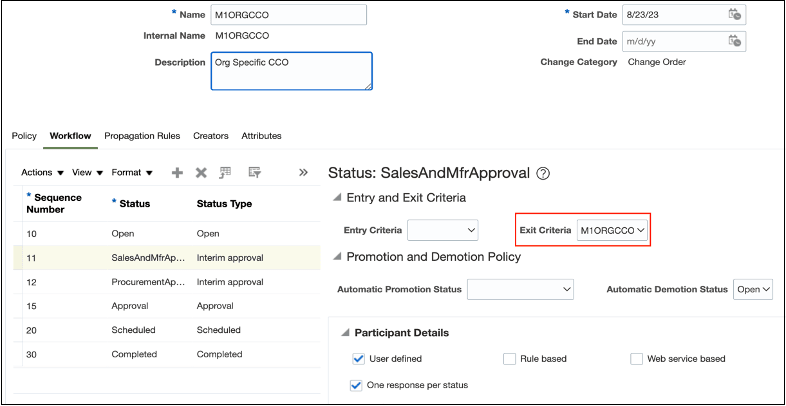

  4. Change order criteria: Define the criteria in the Workflow tab of the Edit Change Order Type page.
    Add the M1ORGCCO rule as the exit criteria for interim approval status.
This image displays the exit criteria
